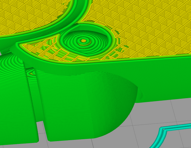

After slicing, that space seems to disappear/ignored, and the highest part of the leg gets cut off and the infill of the body starts overlaying it.
Here I have 0 bottom and 0 top solid layers, because if it does, then the solid bottom layers will be added just like in this picture the infill is, overlapping the cut off section of the leg.
sliced with S3d
sliced with S3d

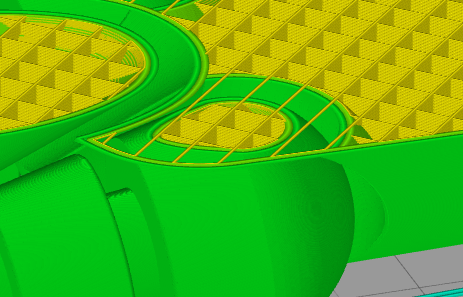

The same area with Cura, only using the default settings. Leg gets filled completely and body does not touch it on that vertical spacing.
sliced with Cura
sliced with Cura
