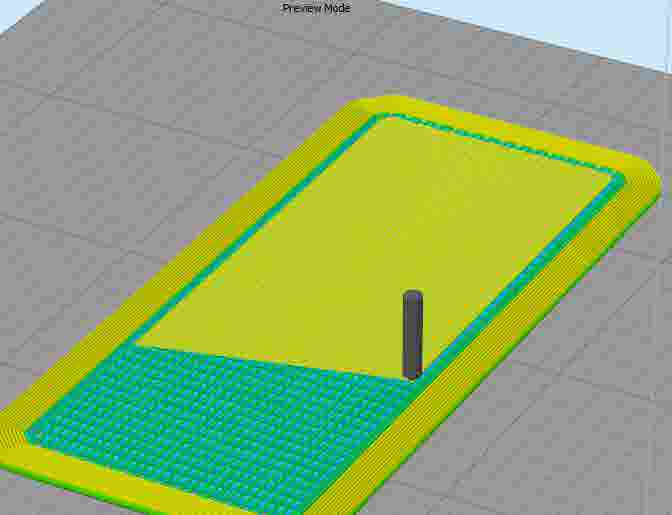

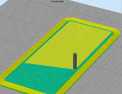

I have to print out an objekt with skirt, raft and support.

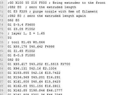

The preview mode shows all as well but the gcode begins without skirt/raft at a high of Z = 1.65 mm
I have no idea what happens.

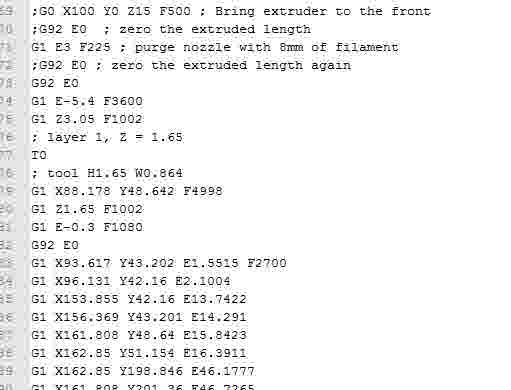

A new one here from this object, but it is not the same (SD formatted after writing to this forum)! Now the gcode shows for layer 1 Z = 0.6.
I would say, when Z = 1.65 is a fault and prints in plein air, then Z = 0.6 is also a fault. I can't test it because I'm not at home (next thuesday), but the the max distance my Mankati can print is 0.4 mm.
Distance bed / nozzle = .15 mm, layer high = 0.15 and FirstLayer 80% = 0.12 ; total 0.27 mm
H.
