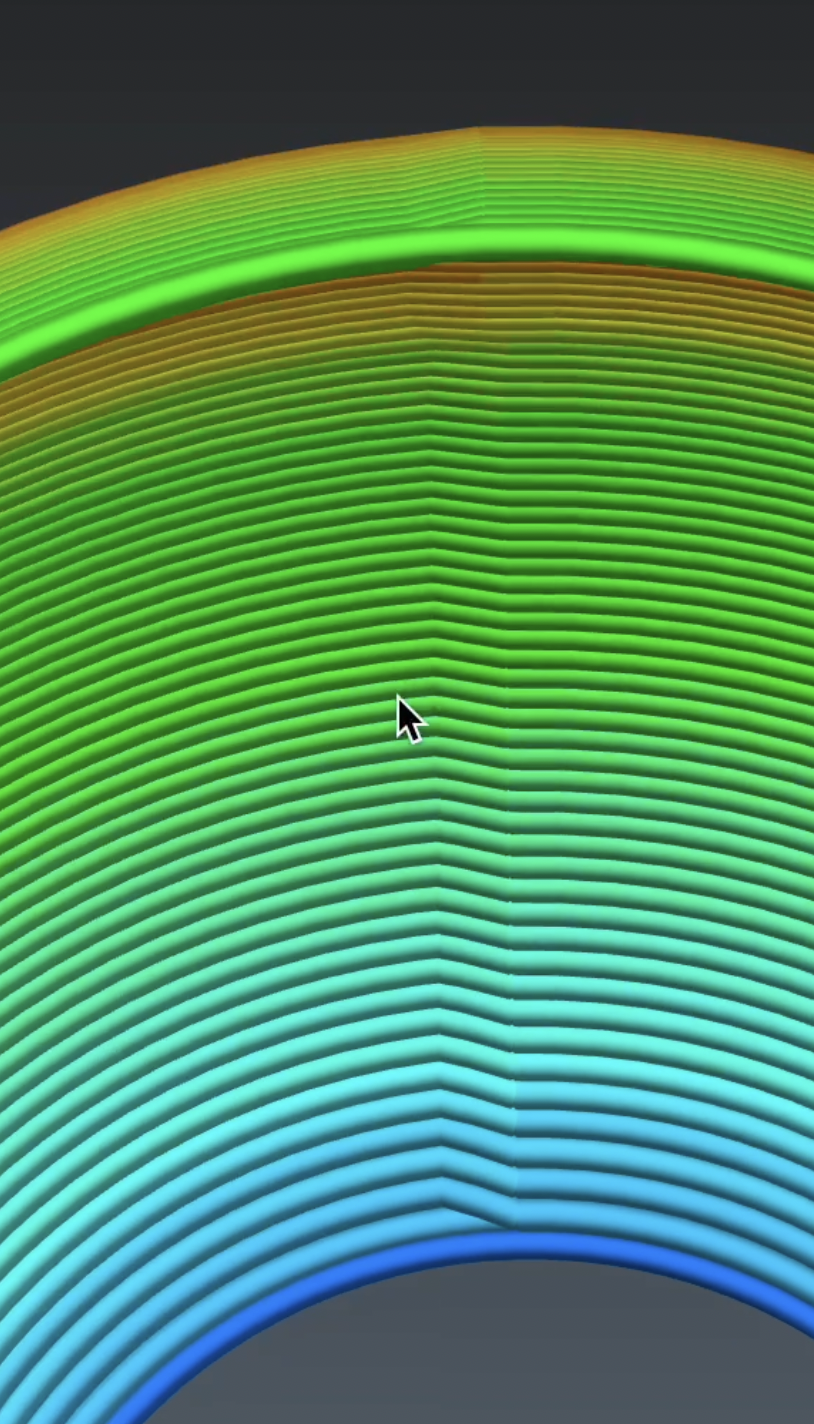

I need to print a bowl shape in vase mode, but I am getting a scar/seam in the print.
The issue seems to be that the spiral is not moving toward the next point in all directions, so there is a big jump when it comes full circle.

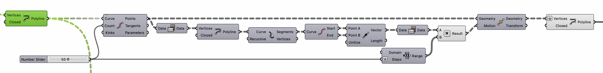

I have been able to write a little script in Grasshopper where each point is moved slightly in the XYZ direction of the next point above, and thus getting no scar.
Can we not fix this bug in a similar manner?
