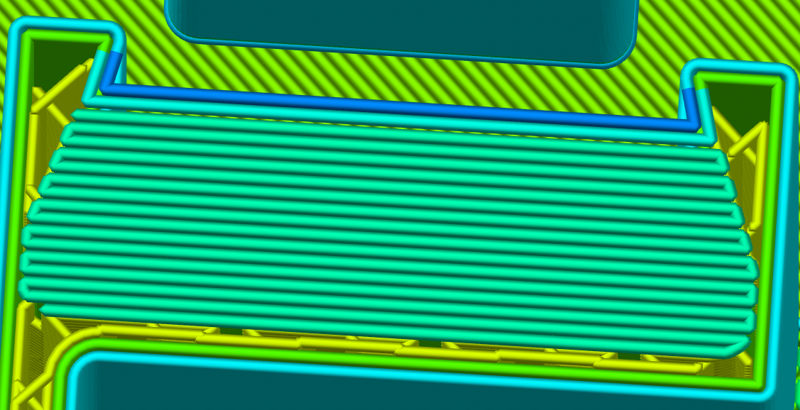

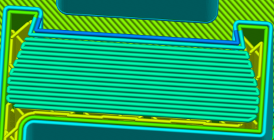

Apply bridging parameters to perimeters applies both the bridring parameters and the perimeters speed.
Simplify3d 5.1.2
My outer perimeter speed is set to 27%, and my bridging speed is set to 40%, but when bridging perimeters the speed is 10% of the normal printing speed, like it is multiplying the two together. I feel like bridging speed should take over and be the dominant speed when bridging regardless of perimeter speed. I was able to change this by making a python post processing script but this should probably be changed in simplify 3d.
