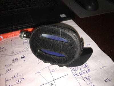

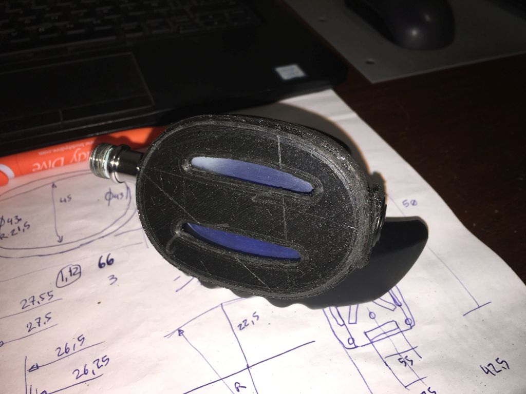

I have an issue with Simplify3D where travel lines are over the printed part and the trace can be seen in the printed part.
I'm using version 4.1.2

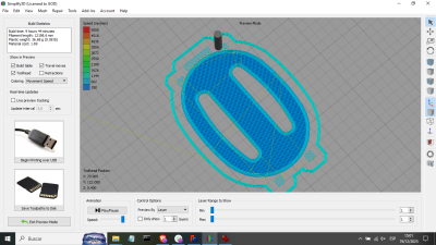

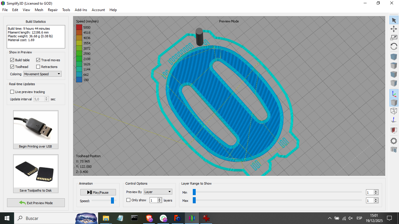

I've configured "Avoid crossing outline for travel movements", but I cannot see any changes in the print head travel.
Attached a screen shot of the travel movements (in yellow) of the first layer and how it looks in the printes part.

If you enable the "avoid crossing outline"-option there's another parameter to look for, the "max detour factor".
Looking at the object and not knowing where retracts are located my guess simply is a too low detour factor.
If avoiding crossing the outline would create a travel move longer than "(detour factor) * direct travel length" it will be omitted.
