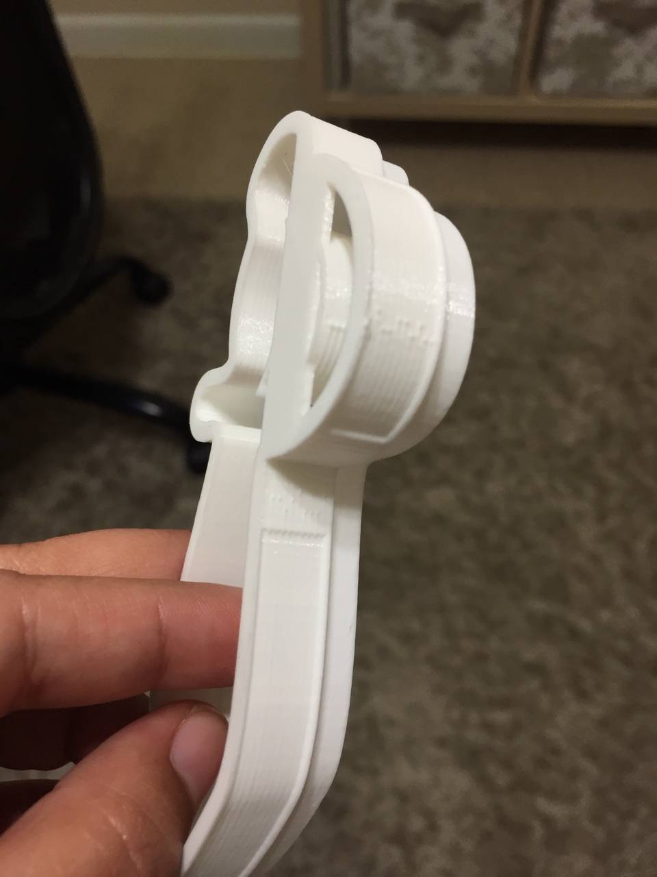

I am getting these streaky blobs around the curves of my prints on the Flashforge Dreamer. Any idea how to get rid of them? I'm thinking the coast or the wipe settings but I'm not sure how to proceed.
Re: Streaky blobs: Flashforge Dreamer
Yes, it looks like your retraction settings are off.
Try to enable coasting with a value of 0.2mm. Then you may also want to set the extra restart distance to a small negative number like -0.1mm. Those will both help to eliminate the blobs you are seeing.
