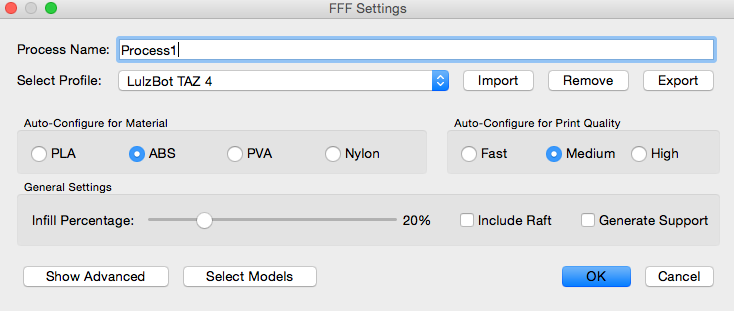

In the software you have "profiles" that you can choose from. Switching between printers is as easy as changing the selection in the combo box. I have created custom profiles (the fff files are simple XML files) for all of my printers, and removed any printers that I do not have (s3d comes with a ton of pre-configured profiles), and now anytime I need to switch to a differnt printer profile, I just select it from the drop down menu.

To add to this, yes, you can easily switch between multiple profiles (either your own custom ones or their pre-configured ones). You can also install the software on up to 2 different devices, so RBeaubien, you should have no trouble managing both of your printers with different machines.

Isn't that exactly what the "Select Profile" drop down list is from the picture above? You select your printer and the software automatically loads all the necessary settings for it. They also have a configuration assistant which does something similar.
