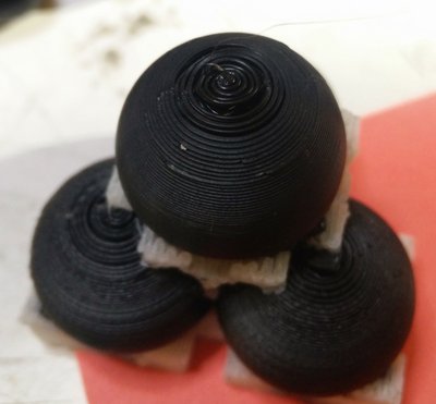

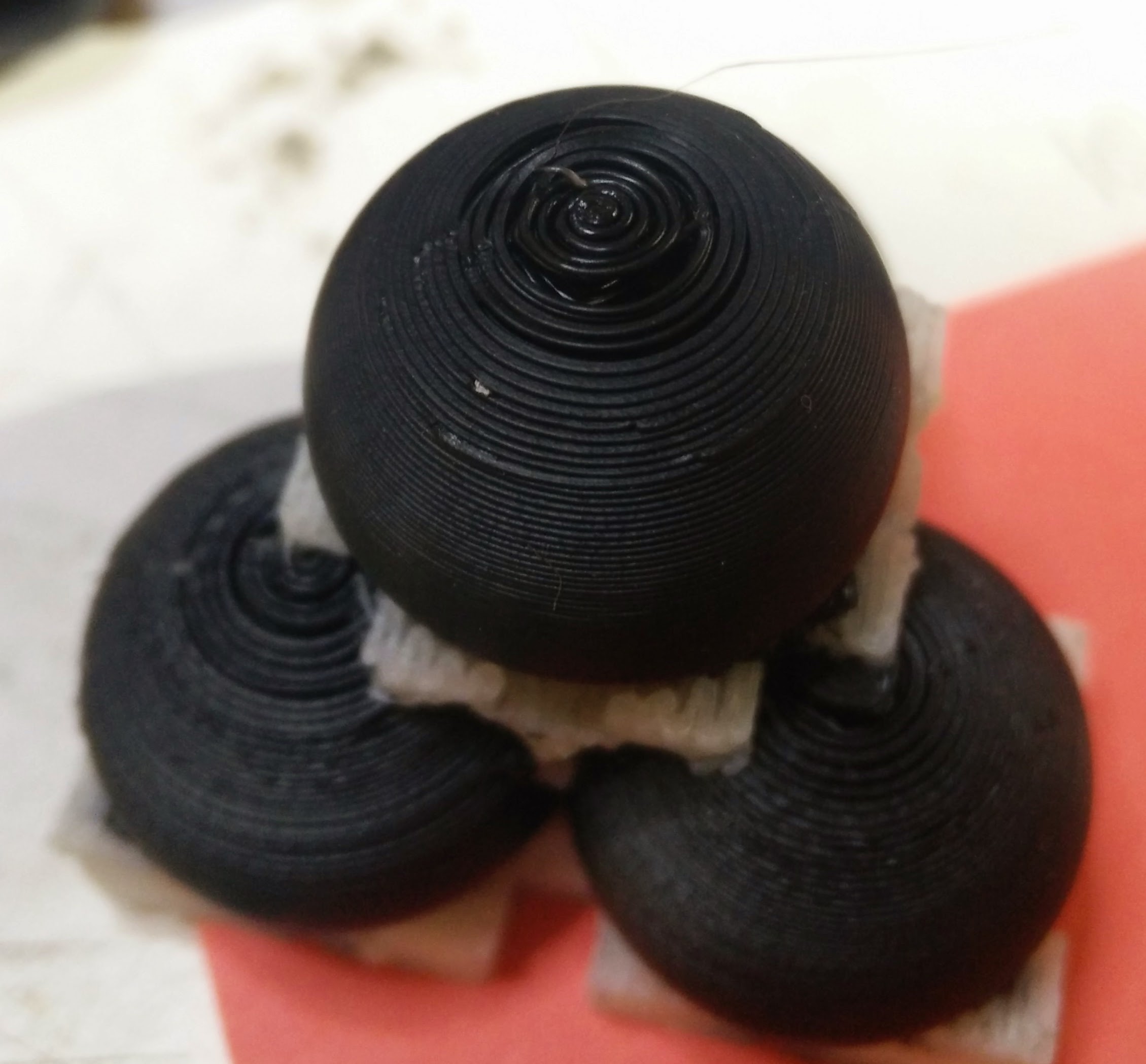

Well... I what I was trying to fix with using a better support did not get fixed. While the support was good, the print was bad. I think I have another problem. See pic

rklosinski wrote:Well... I what I was trying to fix with using a better support did not get fixed. While the support was good, the print was bad. I think I have another problem. See pic
Sphere's a generally difficult to print because of the curvature. Try slowing down your print speed and using a cooling fan (PLA), but even then it's not an easy print

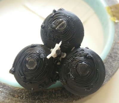

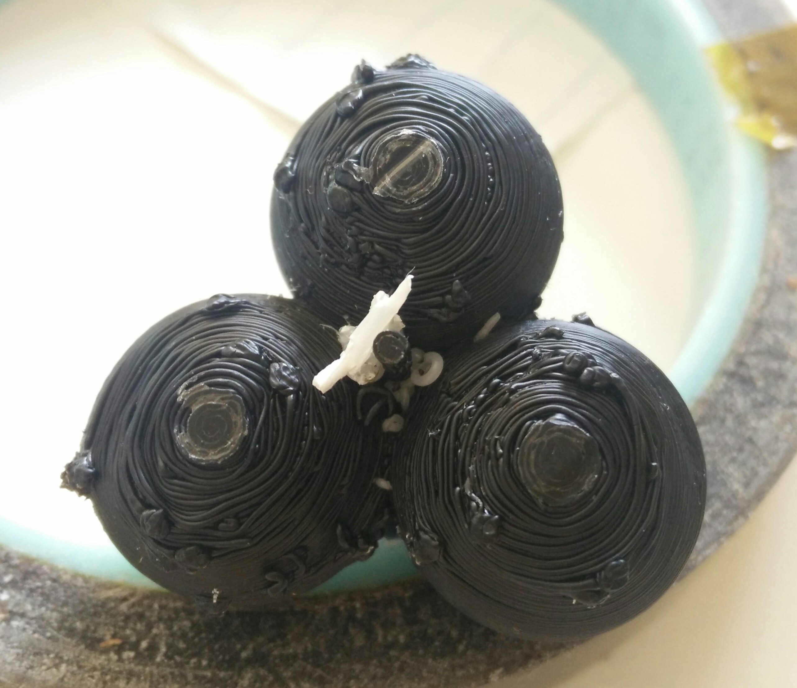

I set the separation from the part to 0, used PVA as a support (removing HIPS is messy) and got good results. Even the uprint I have has problems with the model. Now I have problems with the top (see pic). The plastic barley touches and it can nearly be pushed in.

That post is not exactly applicable. This model is hollow inside (hollow round ball), so in-fill does not apply. I printed the same on a uPrint and it came perfect.

As I was typing the last response I decided to check out the uprint version of the print. It seemed very strong...so I crushed it open only to find a support structure inside! I guess I'll need to add this support manually since the Simplfy 3D did not generate support.
