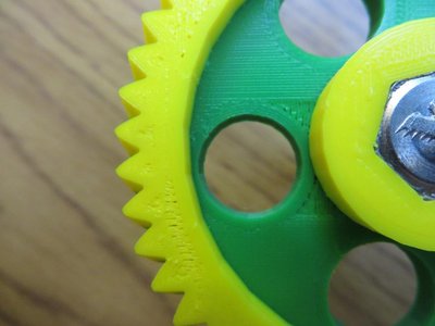

1-2 times per layer, my extruder will "over-retract" during a move. When the move completes and begins extruding again, plastic will not leave the nozzle for around 5 seconds. This leaves gaps in the infill and sometimes the perimeter. When it happens, it tends to happen at the same location on each layer throughout the build. This does not occur between layers, but most frequently while printing infill.
With the exception of these 1-2 over-retractions on each layer, all other retraction operations seem to be working just fine. These are my settings:
Retraction Distance: 2mm
Retraction Speed: 40mm/sec.
Z-lift: 0.5mm
When I print the same part using Slic3r, this problem does not occur.

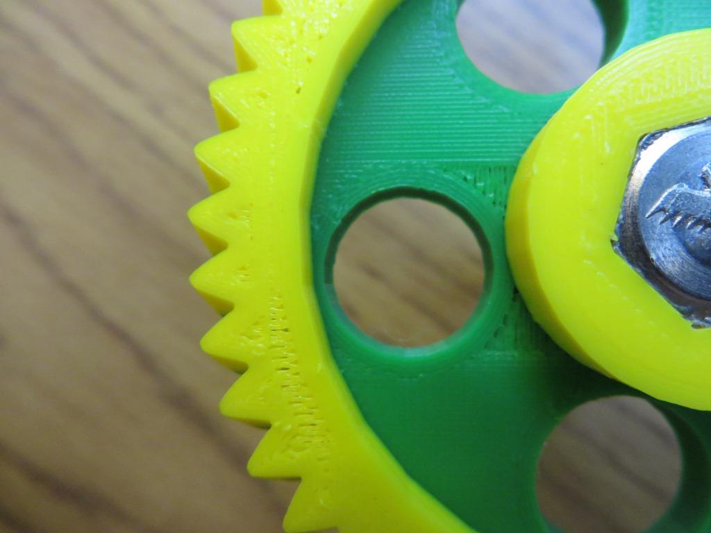

In the picture you can see in the green material a section where the -45 degree infill was not printed because the extruder "over-retracted" just before getting there. This happened in the same spot on every layer that printed -45 degree (+45 degree worked fine). You can also see spots in the yellow material where this also occurred.
Anyone else run into this problem? Any fixes or recommendations? Thanks in advance.
