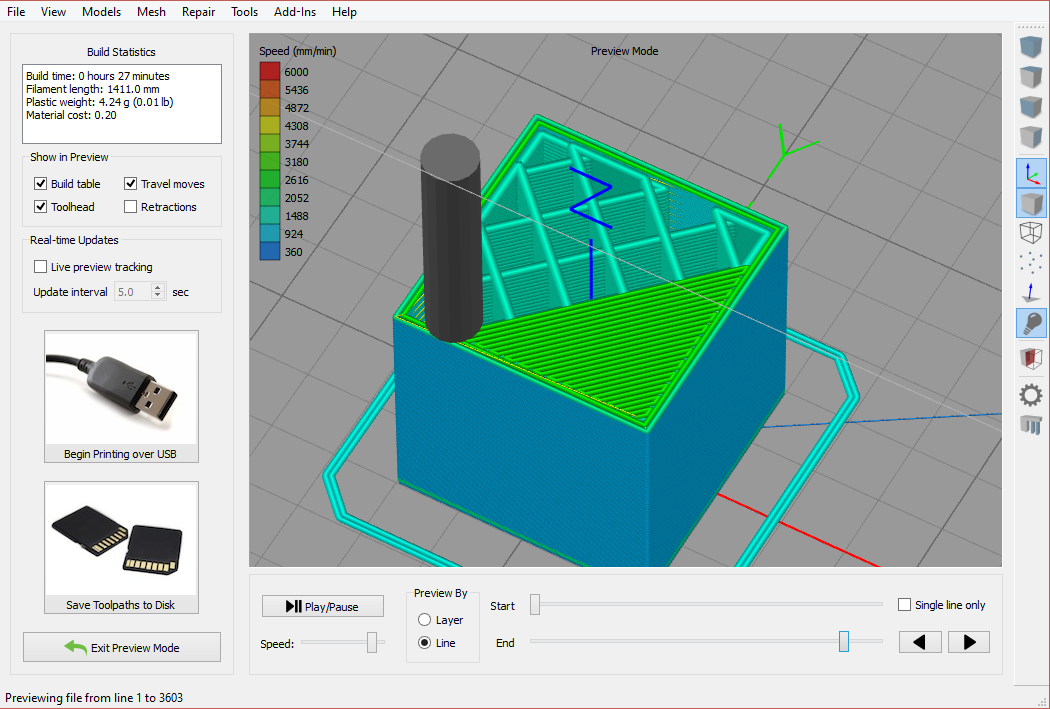

No, The infill extrusion width % setting does not affect solid layers. (top or bottom) This can be seen in the preview window fairly clearly.
Infill extrusion width set to 200%, Solid layer printed at normal extrusion width

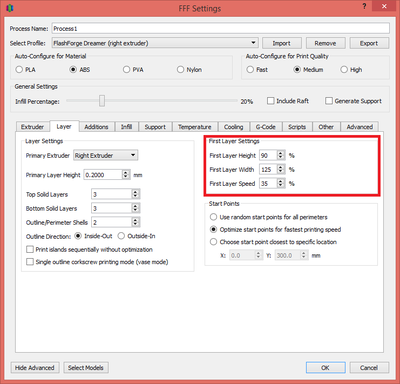

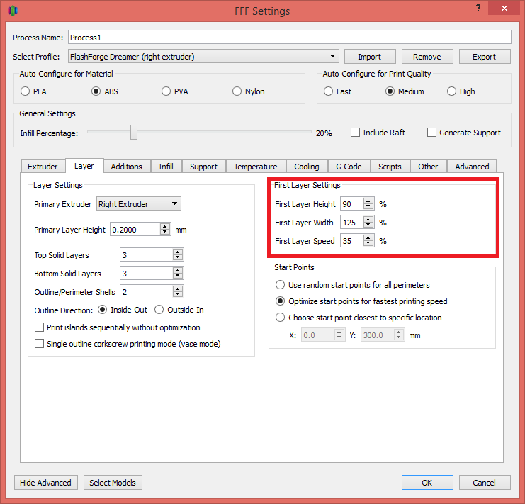

Your bottom layers can be adjusted from the first layer settings area on the layer tab.
First Layer Settings. I find that increasing width and decreasing speed helps here.

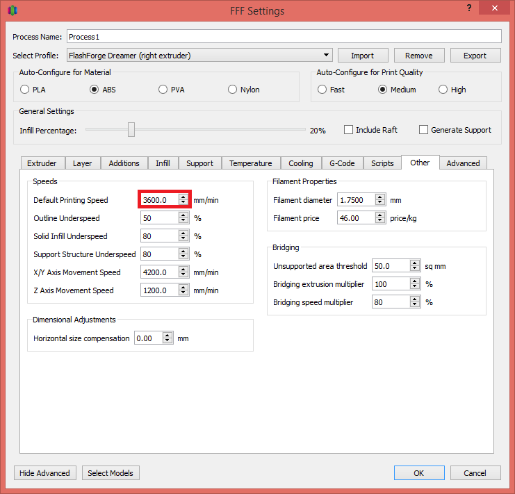

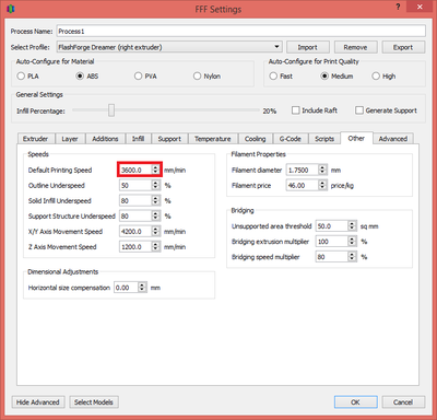

from layer 2 and up any solid layers are printed with the base printing settings. I've found that sometimes I get a smoother surface if I slow down my print speed. now you of course probably don't want to do this for your whole entire print, and neither do I. I use a separate process for my top solid layers, and use a lower Default Printing Speed.
