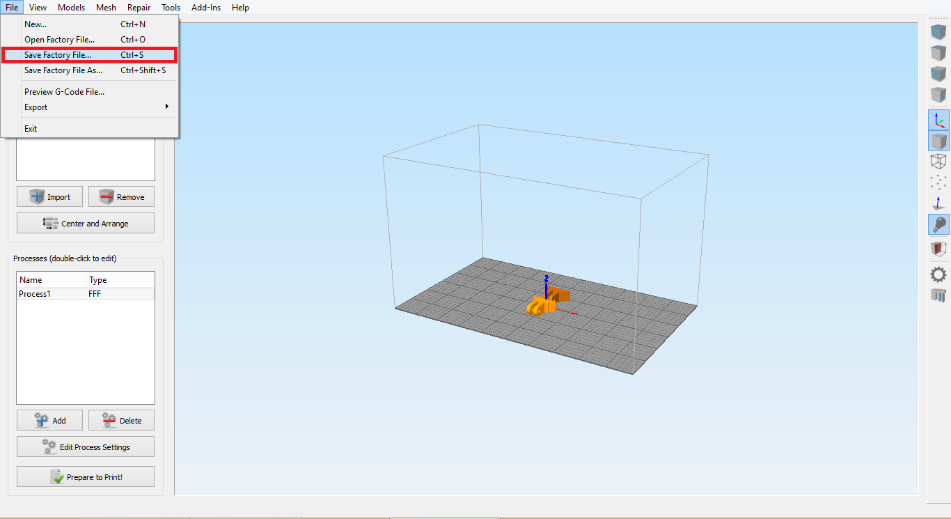

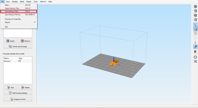

Thin walls can be pretty tricky. If you post a factory file, you'll likely get much better assistance from this community. Factory Files save almost everything. You can save one from the top menu bar.
