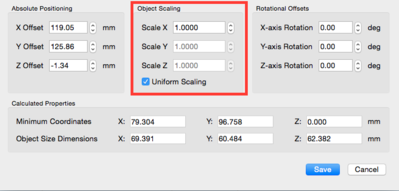

You can quite easily scale in the X, Y, and Z planes. In order to do this you must uncheck uniform scaling from the model settings window. You can open the model settings window by double clicking on your model. Once you have unchecked uniform scaling you can scale the model in whatever plane you wish.
Model Settings Window - SCALE

That's the method I use at present.
What I meant was to be able to scale by setting the x, y & z sizes in the Object Size Dimension boxes.
So for instance, you could set the height to 50mm and it would scale the X & Y dimensions automatically.
