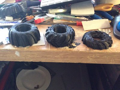

darn it. the print failed with the NinjaFlex. mainly because of the lack of concentric infill pattern.
why did they get rid of it.
great they split internal infil and external infill but loosing the concentric for the internal was a bit of a loss for me.
why was it removed?

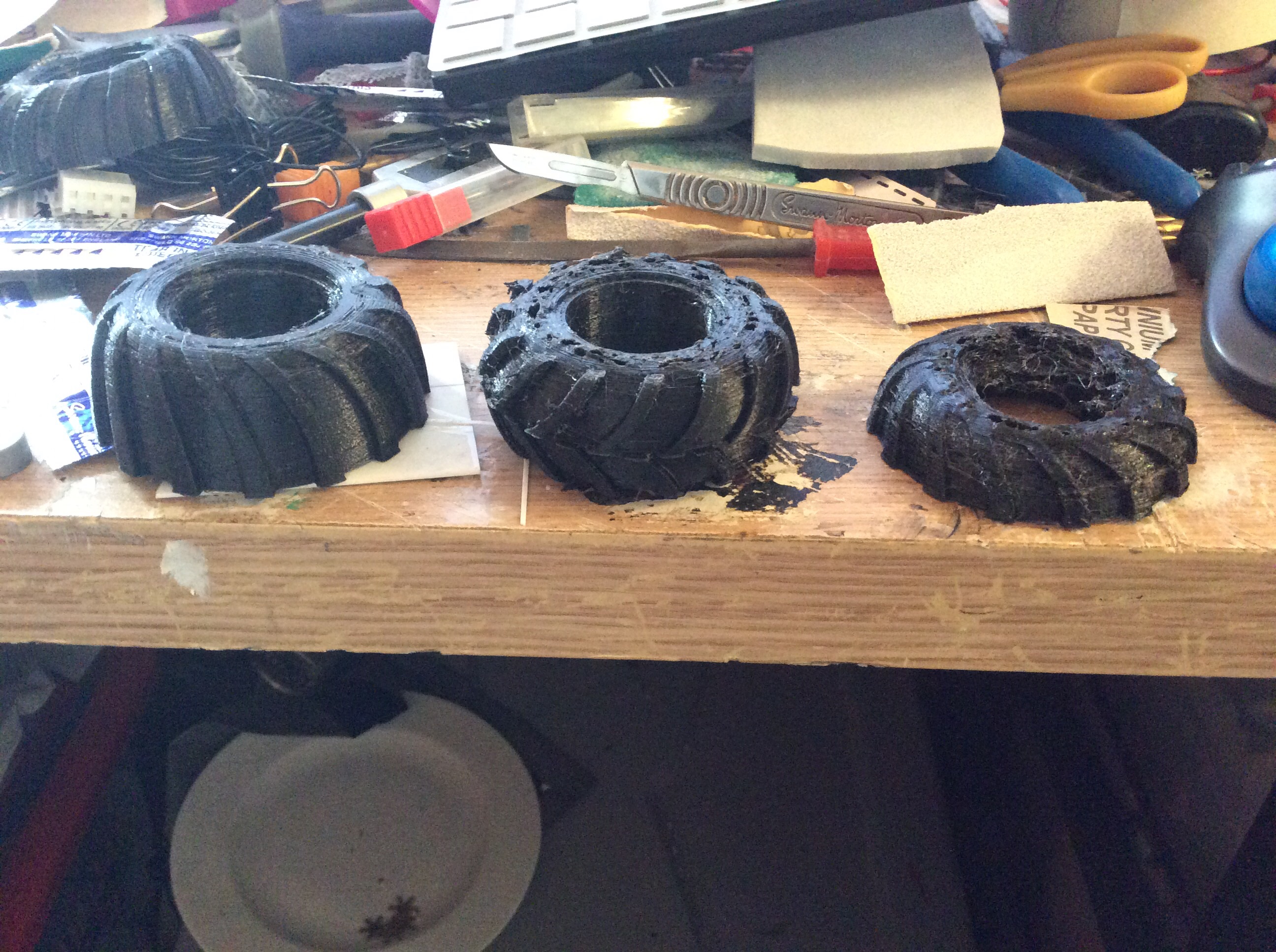

Rebekah_harper
Posts: 263
Re: spoke too soon
Under infil tab you have the choice of rectilinear or concentric. It's there 100% when I use it I what the extruded go round and round, no other movement other than round.
When I print my tires with ninjaflex it's the only one that results in a good finish. I tried with v3.0 and it was a wreck, I used rectangular on v2.2 and still get holes on the top layers.
So it's there in v2.2 and works I've attached a photo of the results, left is the concentric one, the middle is rectilinear, right is V3.0 with the extra over lap for bridging. I'll add a photo to illustrate that it does have the concentric option in a sec

Rebekah_harper
Posts: 263
Re: Concentric infill pattern
I know you emphasized INSIDE and on 2.2 is states external but if the setting in infill only does the top and bottom layers as per the setting then I should have a gap in the wall. similar if not the same as vase mode.
So I'm in a quandary as you can see the see from the results the 2.2 on the left is the best one with 100% infill. But on 3.0 I can't get the same. As you can see on the right.
So if you are correct, are you saying 0% infill in order to replicate the same conditions?
