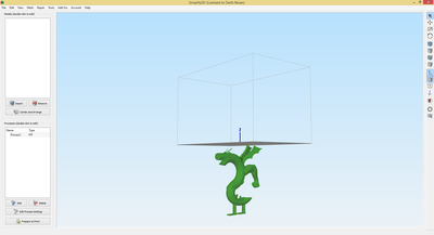

There is a toggle in the xml for FFF profiles. if you toggle this setting off, you'll be able to set your own bed model and have it saved for each time you open.
  1. Goto File then export FFF profile. Select the profile you'd like to export (the one that will have your bed model.
  2. Open the FFF you just exported in a notepad (text edit on mac)
  3. Change this line
    Code: Select all
    <overridePrinterModels>1</overridePrinterModels>
    to
    Code: Select all
    <overridePrinterModels>0</overridePrinterModels>
  4. Save the edited FFF.
  5. Use File -> Import FFF to get the profile back into S3D.
  6. Open up FFF settings and switch to the freshly imported profile.(It'll, more than likely, have a (2) behind the title)
  7. Close S3D with the new bed model set.
  8. Open S3D to find your custom bed model still there!
Trogdor Custom Printer Model
