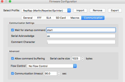

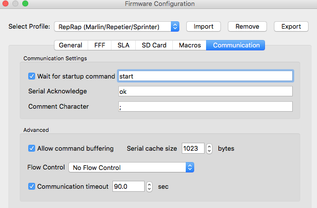

I had similar trouble until I did the following:
In the Firmware panel
Set the Communication Time Out to 90 seconds (I had large files that needed more time to download to printer)
Set the Cache size to: one less than the amount of memory you want to allocate (depends on how much memory you have)
In the Machine Control panel
Set the Baud Rate to 250000 (may not matter but no harm setting to max)
Note: The problem for me may have been as much related to my DaVinci 1.0A printer.
I had too many problems with S3d 3.0 and 3.01 so I didn’t bother upgrading to 3.02 and am happy with 2.2.2 even with it’s bug’s…
I’m running El Capitan and it also ran on SnowLeopard and Yosemite without problems after I made the changes. Attached screenshot...
