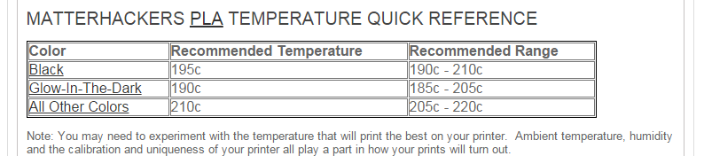

Think you should lower your extruder temp to max 210. And if print with black PLA or darker collour even more.

Not sure what "Black PLA" or darker colored would have to do with it? Granted about 2/3 of my PLA is Translucent or partially translucent (I have like 10+ rolls of PLA)

I print mostly kind of big things. Around 200-400g of filament / print at 0,2mm. Nozzle is 0,4. I have not changed the default settings for separation distance (0,14mm). If the object sticks tuff to the raft its never the solid infill, only outline. This has to do with a lower speed 50% for outlines and 80% for solid infill. I also thought it was a bit strange that the colour of PLA could affect the temp, but it does.

Thanks for the info, generally before I have just printed around 220/230 regardless of color and had little issues.
