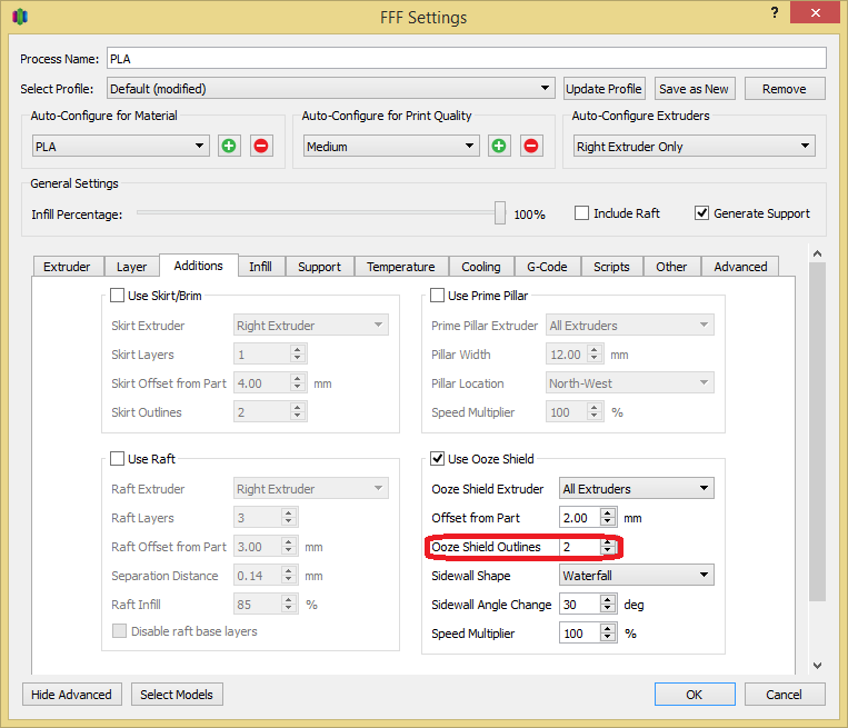

So I don't normally do two colour printing - I even downgraded one of my Rep1 clones to a single extruder for reliability, but I thought I would have a go at printing the cone. The problem ins that the purge walls are too thin and detach and then I have a horrible mess. How do you make them thicker and more substantial ?

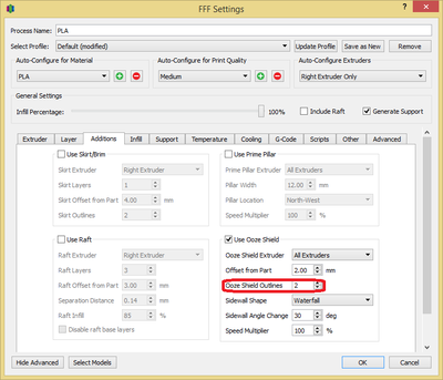

Oozeshield outlines lets you set how many lines thick your oozeshield will be. The default is 1 but you can go as thick as you want..
