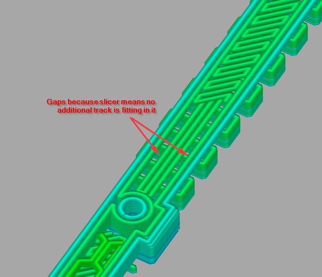

I wondered if it is possible to avoid the bridging infill when support is used.
My problem is, when I have a very narrow piece which has to be supported, there is still the 90° infill for the first layer on the support structure. It would be nice if it is possible to deactivate the bridge infill pattern if support is used, since the 90° can sometimes not fill out the whole piece so I have very long slots on print (see image).
Playing around with the extrusion width doesn't help because the I got problems on an other part of the peace. As well increasing the outline overlap doesn't help.

You can easily disable bridging on a print by increasing the bridge threshold. This will give you normal printing behavior instead of bridging modifiers.

Oh man, I totally missed that parameter. Thanks a lot.
