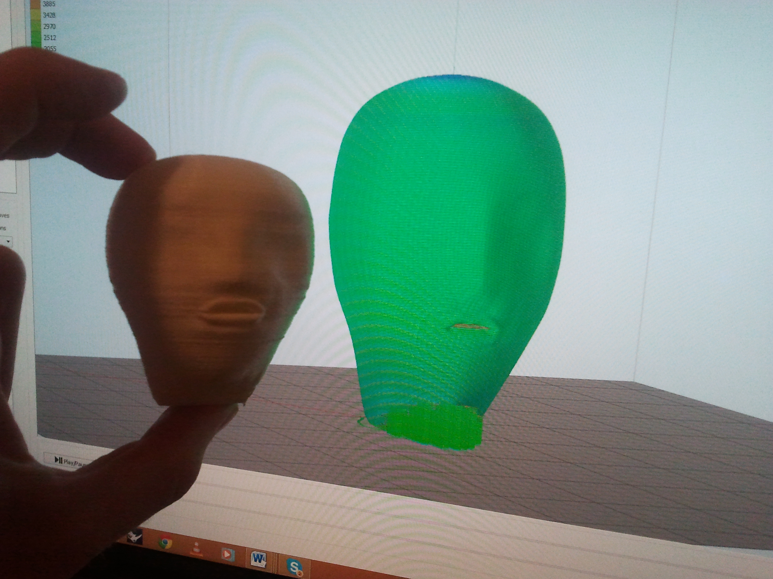

3.01 Models print short, squashed in Z axis.
Is anyone else having an issue in 3.01 with models printing shorter than they're supported to be.
I suspect it's something weird with layer heights.
The weird thing is the g-code previews fine.
However, it's not my machine, cause I just ran a print with 2.2 and got a fine result.
So if the g-code is the right height (in preview), why is it coming out squashed?

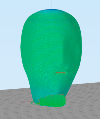

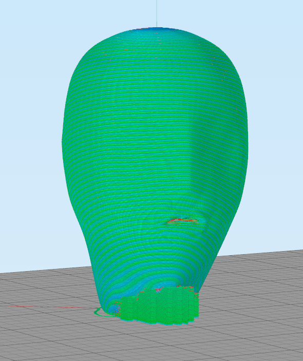

As previewed
As previewed
As previewed
As previewed

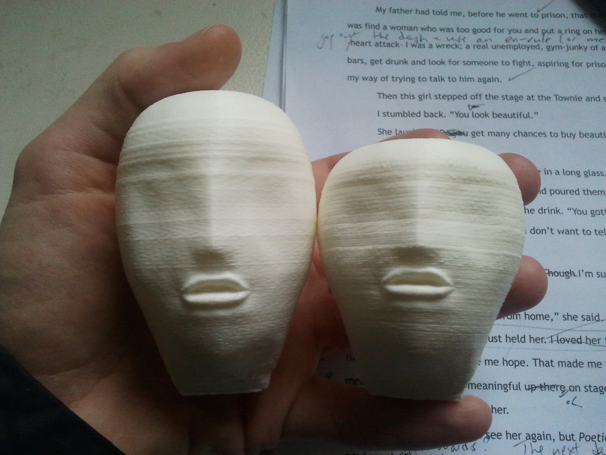

Printed, shorter than should be.

btw looking at your picture its interesting to note that your squashing doesn't start until it gets to the nose!
Manifester
Joined: Thu Nov 21, 2013 1:43 am
Re: 3.01 Models print short, squashed in Z axis.
I know right! What is going on?
