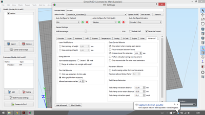

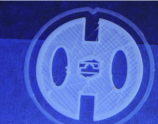

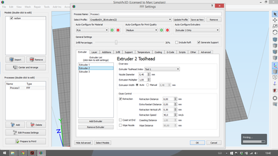

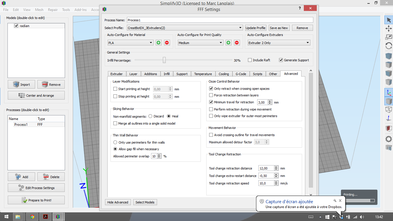

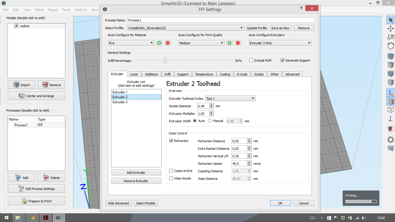

I have lot of oozing on my creatbot Dx. I tried to use some parameter from creatware, the slicer from creatbot. They set the retraction at 10mm. 10mm works but due to the long pause over the print, I have retraction spot on my prints.
I reduce to 6mm the retraction stringing appear and retraction spots are still present
Temperature of Nozzle: 190
Thanks for your help and sorry for my bad english!
Marc

Why don't you use a faster retraction speed so it doesn't take so long to retract?
You could also use some coasting to help relieve excess pressure in the nozzle before retracting

I to also have a Creatbot DX 03. And I am having retraction issue printing. Items
What is the best retraction settings you have found.
In creatware. 6mm seems fine. But if I use it in simplify3D I get under extrusion and prints fail.
What's the best settings you have found. I want to print a 3dlabprints RC plane.
Cheers
