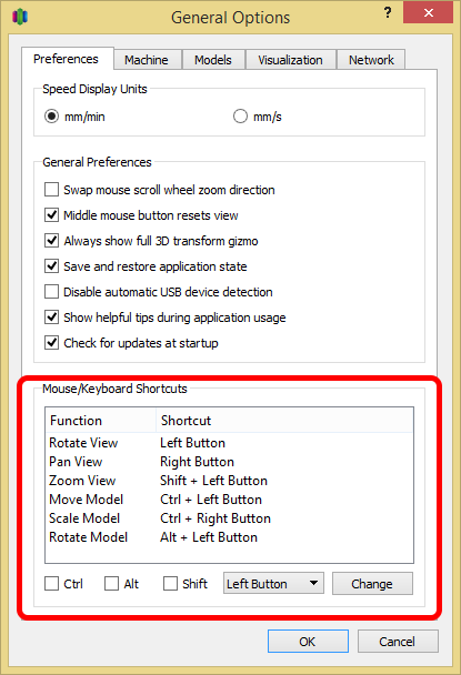

I had a similar problem on my previous laptop. I couldn't zoom in or out due to two finger scroll not being a function of that touchpad. You can change what the keyboard/mouse shortcut is for various UI things from the Options menu, which you can open from the Tools dropdown menu. I found that I didn't need to change the shortcut I just needed to know what it was. To zoom it was Shift + Click and drag Left Mouse Button.
The menu looks like this:
I hope this helps you out. I was really happy when I figured it out a laptop or two ago.
