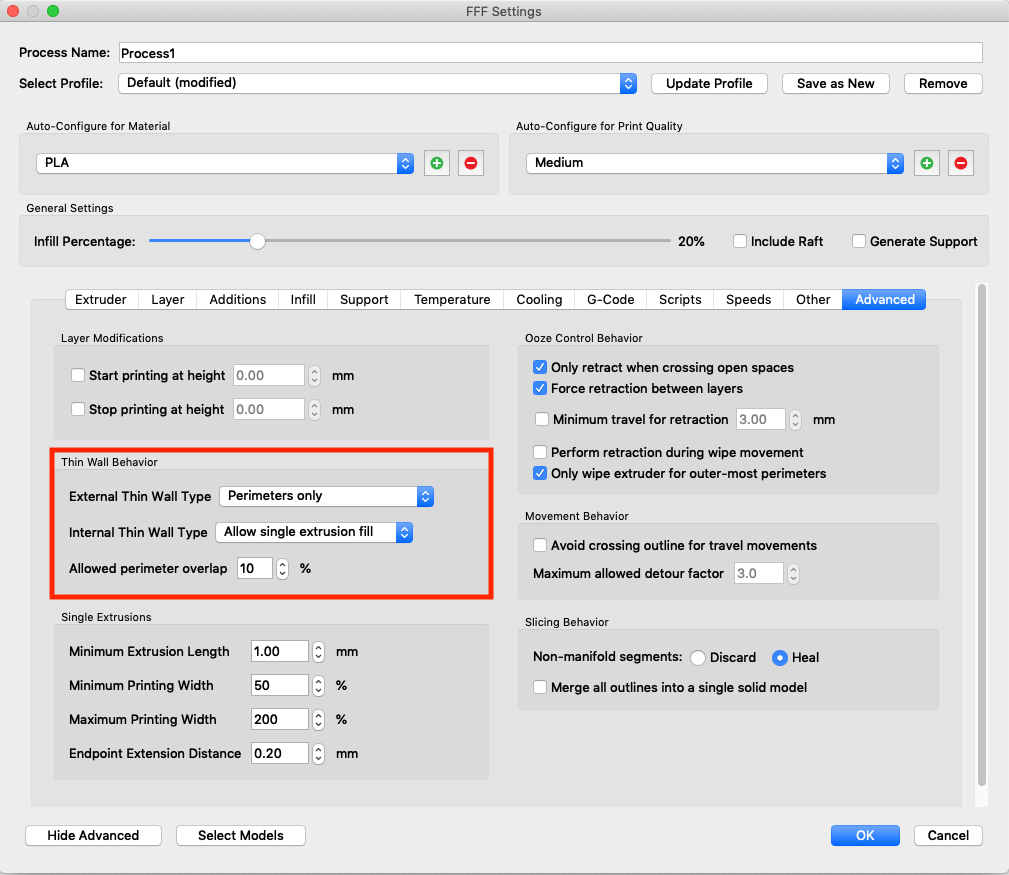

I'm not at a computer with S3D installed so I'm not certain of the exact terminology - but look at the ADVANCED tab at Single Extrusion Fill
Re: Odd number of perimeters for thin walls

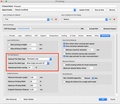

Zemlin is correct. In the advanced tab look at the section titled "Thin Wall Behavior". Setting "Internal Thin Wall Type" to allow single extrusion fill will have small areas within the specified parameters to be filled with a dynamic extrusion width single line that doesn't need to be an entire "loop/outline".
Internal Thin Wall Type - Allow single extrusion fill
