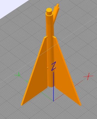

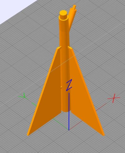

JoeJ wrote:I've also had a printer where the vibrations caused similar layers like in your picture.
I've had similar where a tall thin part was unstable, so I added pinpoint joined "rocket fins" to steady it:
The fins were twice filament thickness thick and the scarring from the joiners was minimal.
