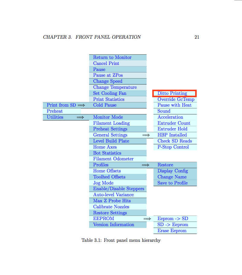

Sailfish firmware,
they call it Ditto Printing. You can read up on sailfish firmware here. Sailfish is nice because you simply switch on ditto printing and then it prints with both extruders instead of one as the gcode/x3g file would initially intend. Here is a snapshot of how you would navigate to Ditto Printing if you have a sailfish printer.

I do have a sailfish printer so that will be a lot easier than I anticipated. Thanks :D
