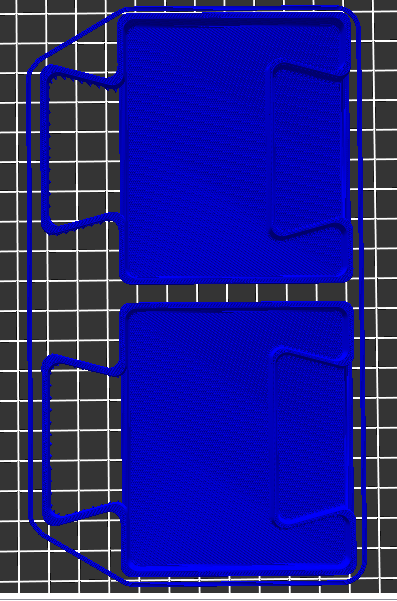

I print a few hoops to warm up the filament; it doesn't need to be a perfect outline of the models. Just wastes time. "Internal" hoops are just more crap to clean off my bed, too. Here's how slic3r does it:

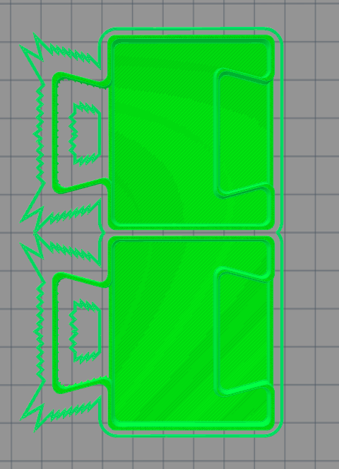

Here's how Creator does it (note that there's zig-zaggy manually created support material that's obscured in both screen grabs):
Having at least an option to do it more like Slic3r would be a good thing IMO.

I'd like to see some clarification on the request for the hoops thing, because it may be my old eyes, but I'm not seeing the difference between the first two pictures.
Paul
Hey Paul-
phpBB munged my post. The blue pics (repeated, it seems) are what I think is a desirable hoop; the green (at the bottom) is what Creator does.
