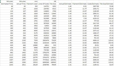

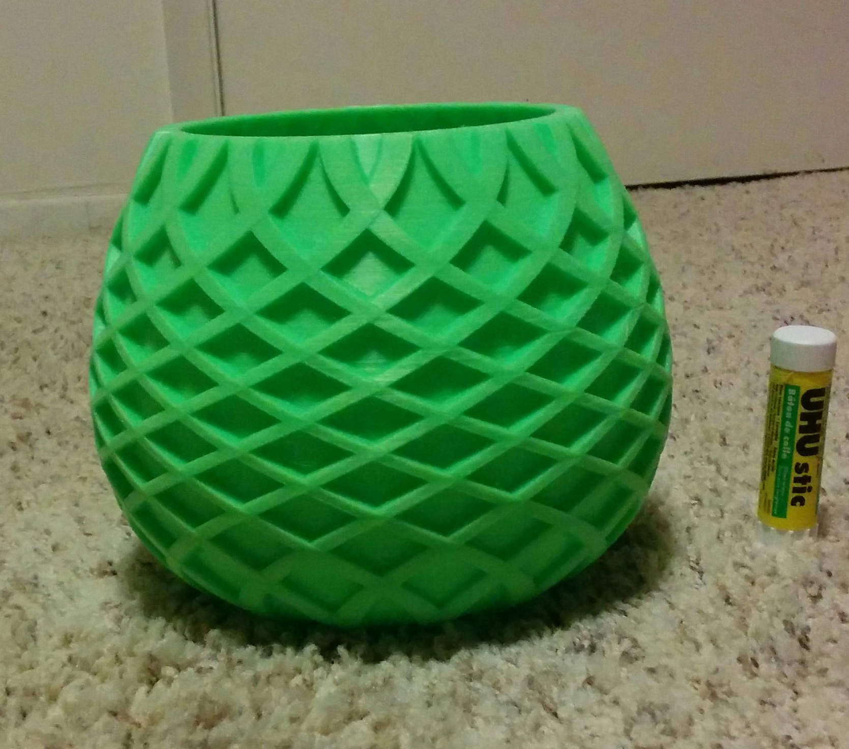

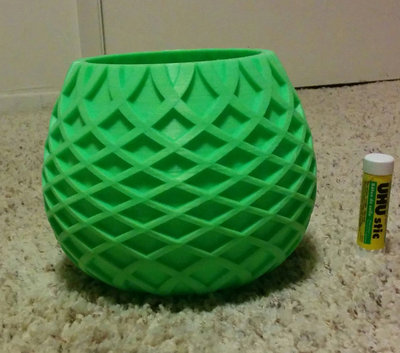

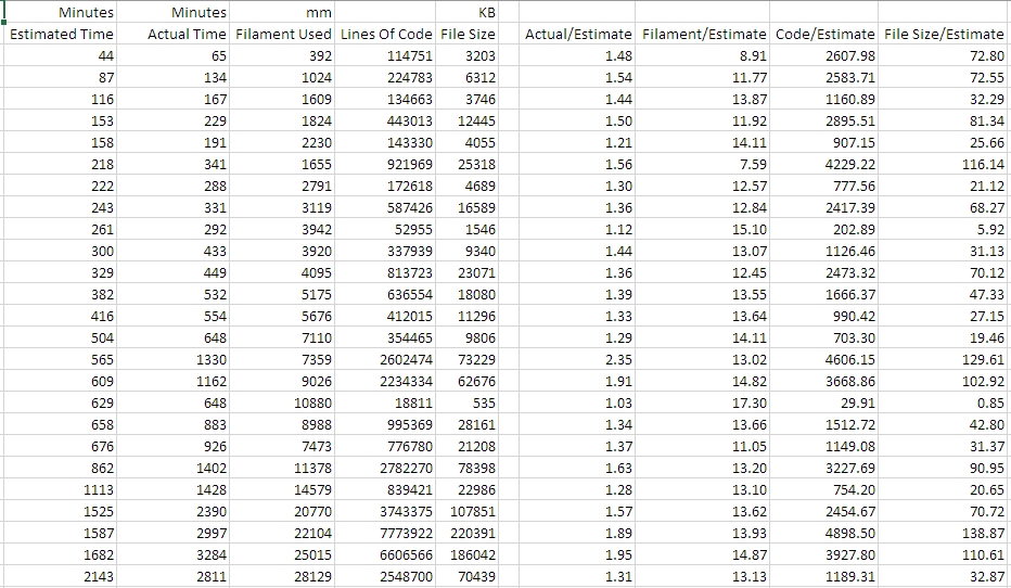

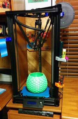

This is the largest part I've printed so far. Estimated time was 33 hours 47 Minutes; actual time was 30 hours 24 minutes.

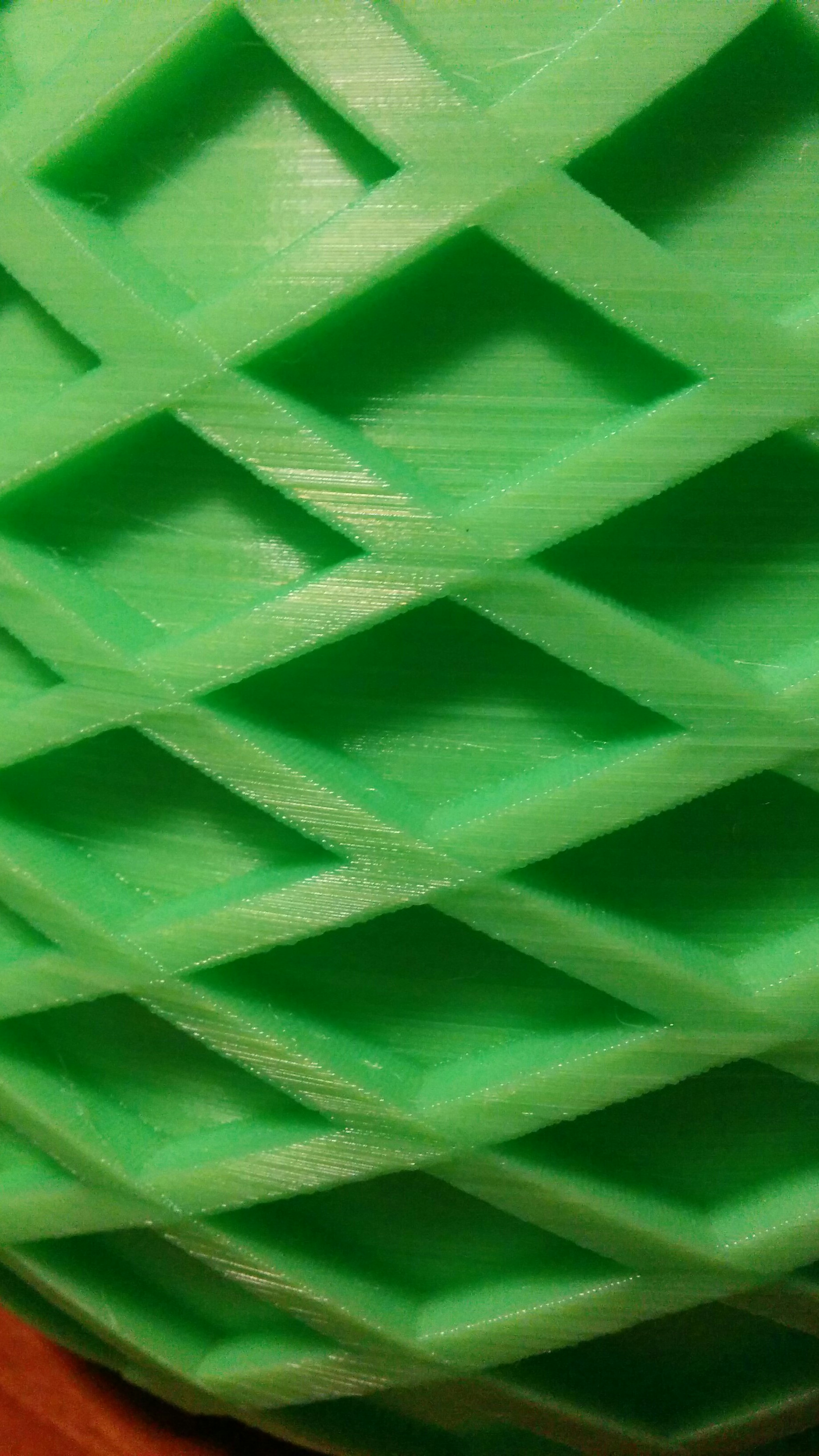

I used Layer Height = 0.200 mm and got good results with detail

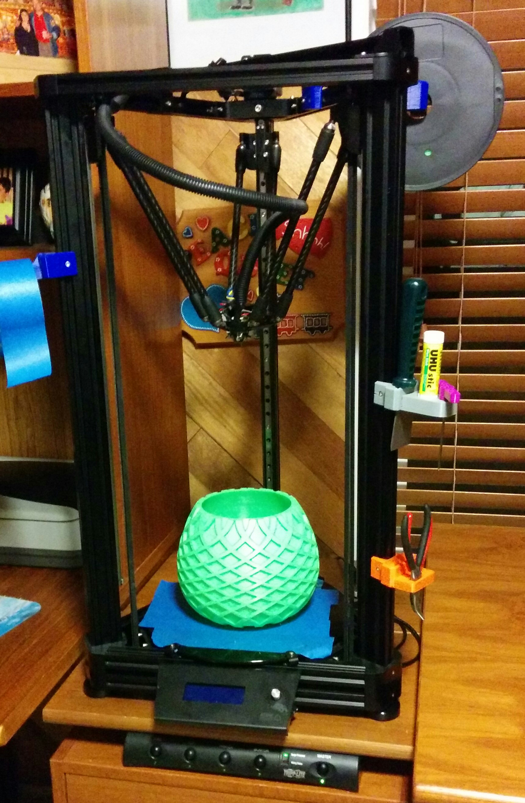

This is the finished part on my Atom2 printer
Only problem was some extraneous hairs/strings, mostly on the inside of the part, that I vaporized with a hair dryer. My sense is that it is essentially impossible to eliminate all hairs/strings with a Bowden tube printer.
