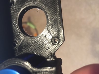

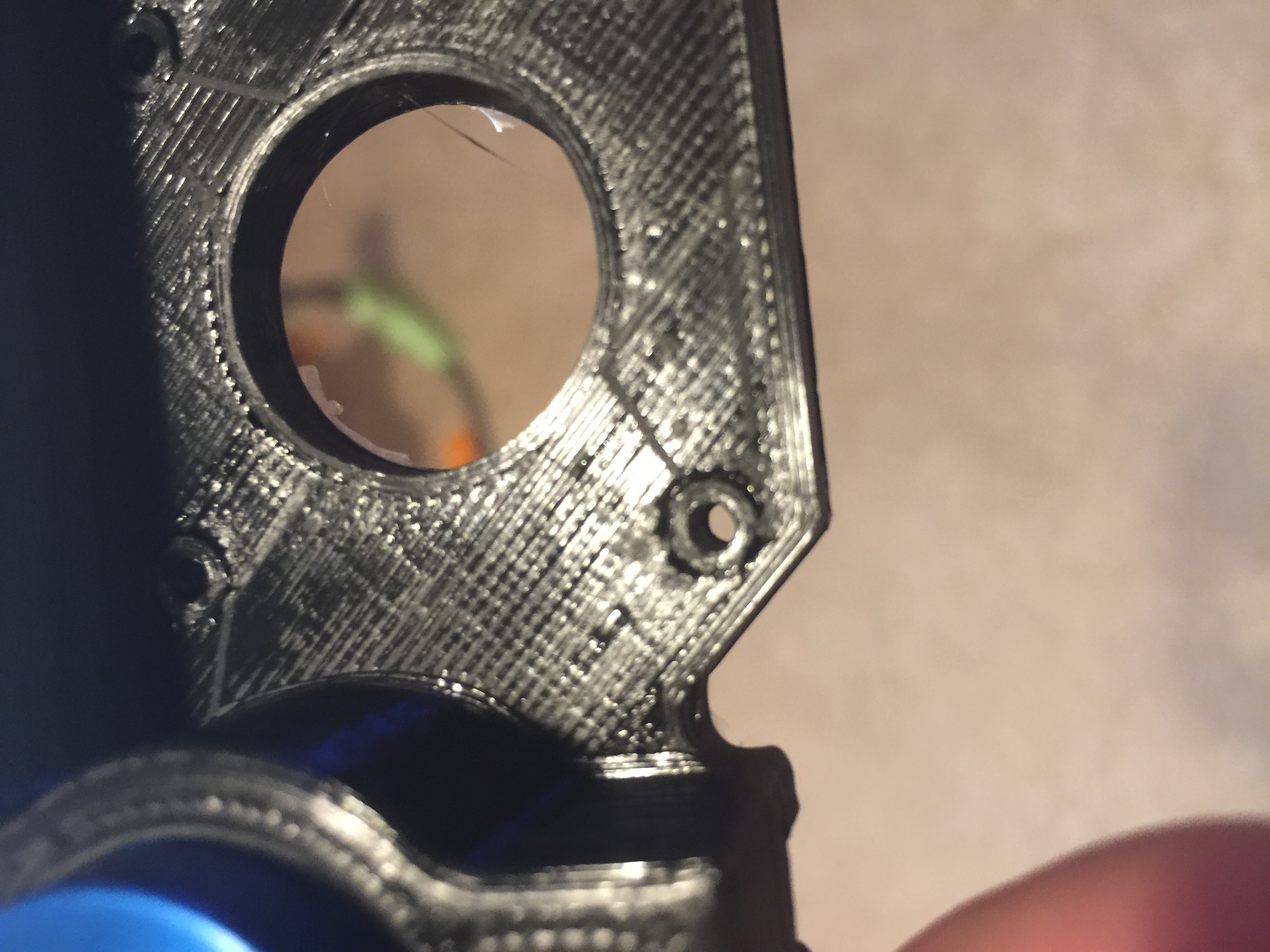

Since upgrading to V3 I have noticed two things with my printer.
The first is that my direct drive extruder seems to skip steps when I am using S3D for a print, I am not getting this problem with kisslicer. With the exception of the second problem I am having the prints turn out fine, I'm not 100% sure whats going on here.
The second problem I am having is that the top layer is leaving gaps around holes, as you can see in the attached picture. I cannot see how any settings could be causing this but does anyone have an ideas? The printer prints fine when using KISSlicer but I get this problem with S3D.
Gap Example
Gap Example
Re: Top surface infill problems on V3
For 1, turn down the xy movement speed. For my printer, default is 18000. Turn that down to 9000-12000. Also turn on some vertical lift. 0.2 mm is usually good. I dont know your printer or firmware. But skipped steps come from a whole list of different items. The above will cover the more common issues. If marlin firmware the arduino compilier version will cause skips also. You need 1.5.5 or below.
For 2, increase your outline overlap in the infill tab.
I am using a cubex that I have converted to a ramps/marlin system. I am running the 1.1.0 RC build.
1. Are you talking in mm/sec or mm/min for these measurement. Currently I print at 50 mm/sec. Just so we are 100% on the same page, I am only getting skipped steps on the extruder. I will try adding some vertical lift. Prior to upgrading to v3.0 I did not have skipped steps on my extruder. I also do not get skipped steps with other slicers.
2. I will try this/.
