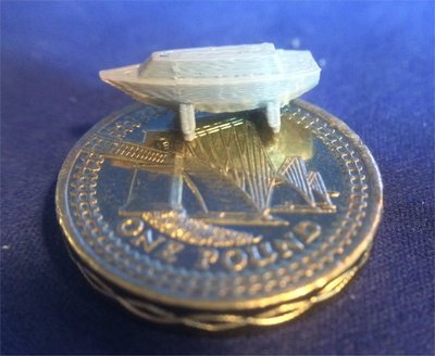

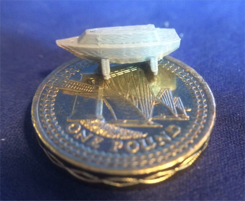

Having said that, it is possible to print small things with a 0.4mm nozzle...but they have to be designed to be printed. Here's an example of something I've been able to print:
CT4

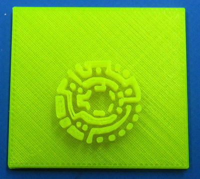

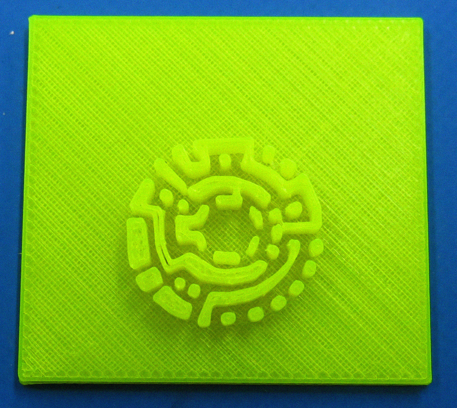

As all ready noted it is a very small print and not really suited for FFF type of printing. I did this on my replicator 2.

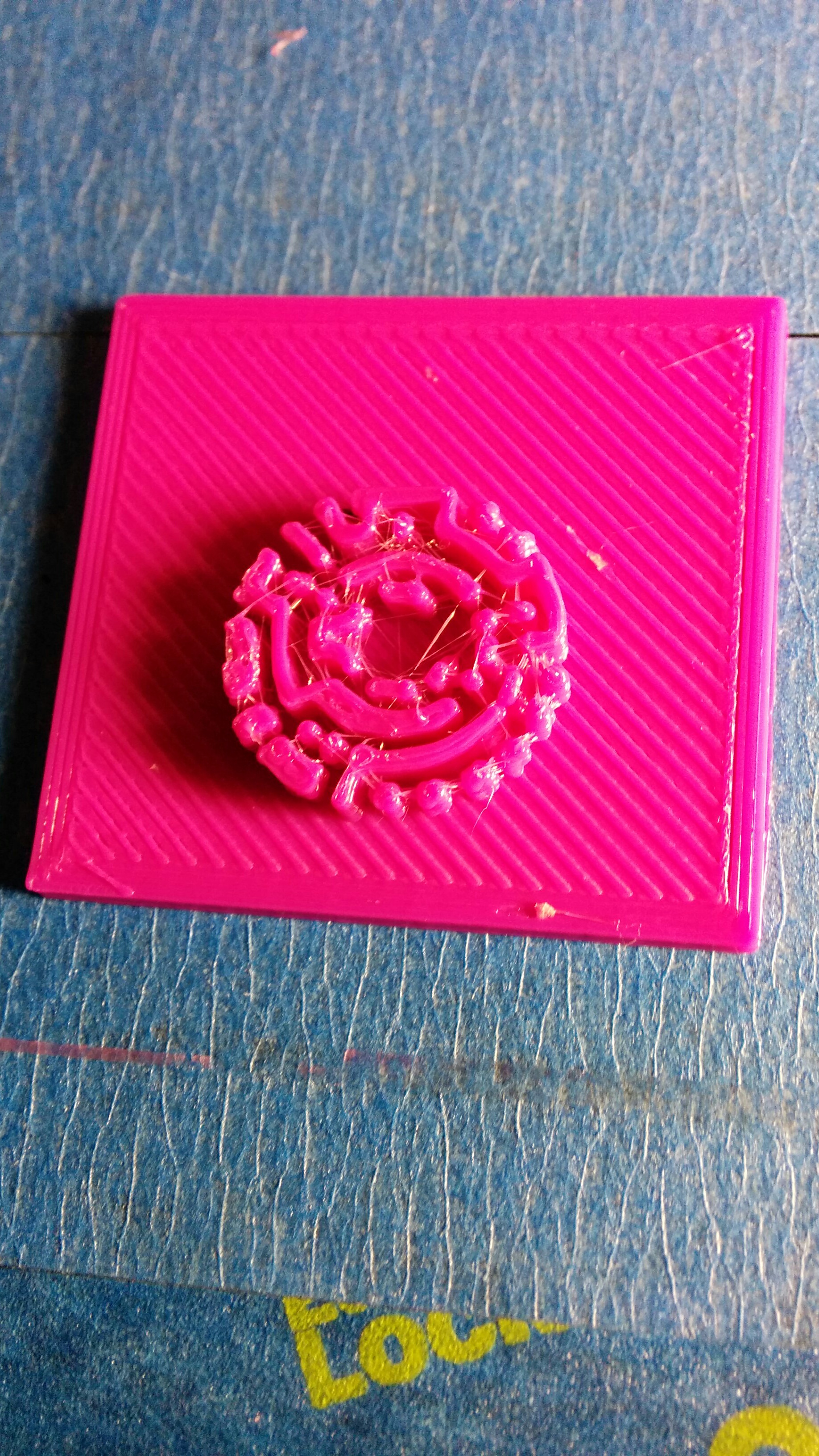

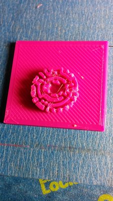

I tried printing the part in a free slicing software (matter control) and it came out much better than in S3D. The size didn't seem to be a factor in that case.
dkightley wrote:If you're seriously wanting to print items this small and complex, you're going to have to use a much smaller nozzle. Either that...or design the parts you want bearing in mind the limitations of the printer when working at such a small size.
My printer seems able to handle the part fairly well on another slicer. What am I doing wrong in S3D that I need to change?
