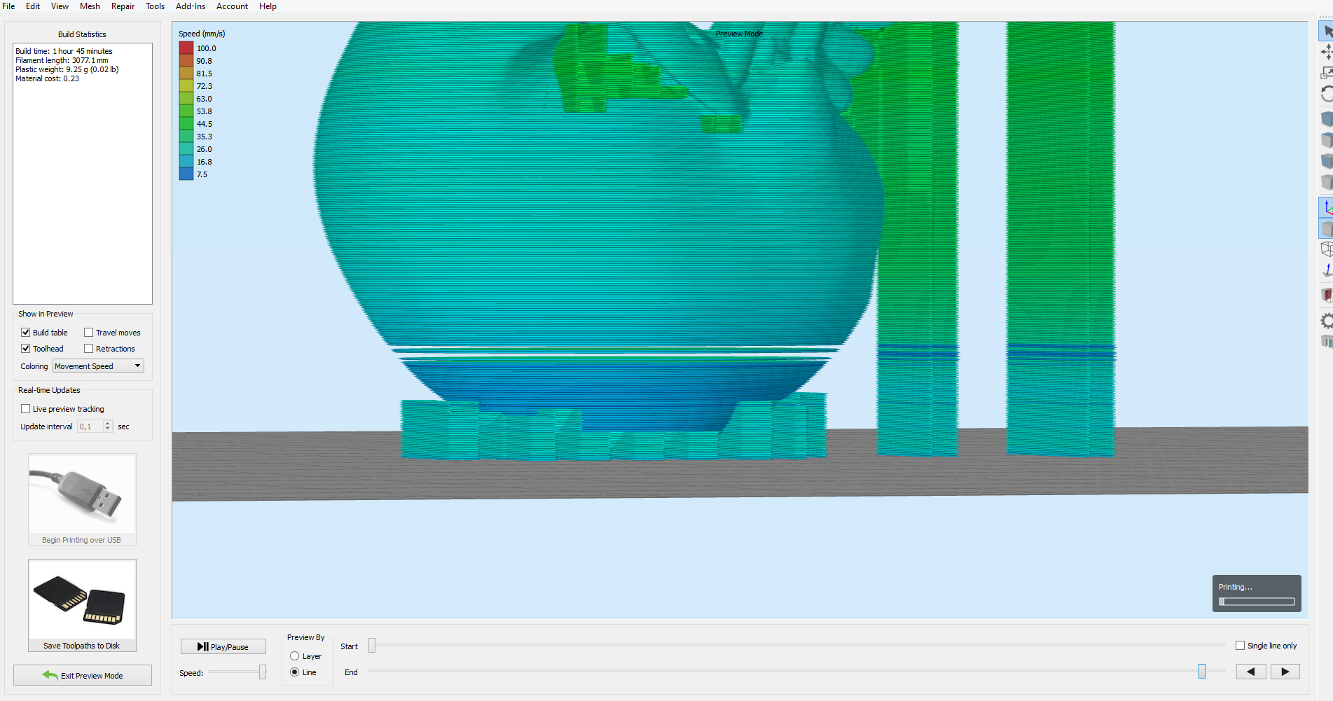

TrevorPhilips
Posts: 20
Joined: Sun Sep 20, 2015 4:58 am
Re: 3.0.2 Strange slicer bug with first layer height 100%
Same thing, missing lines.
If I rotate (or sometimes resize) the model I want to print, strange caps appears. The skull on the pic works OK if I let it be on it's original position.
Missing lines
Missing lines
