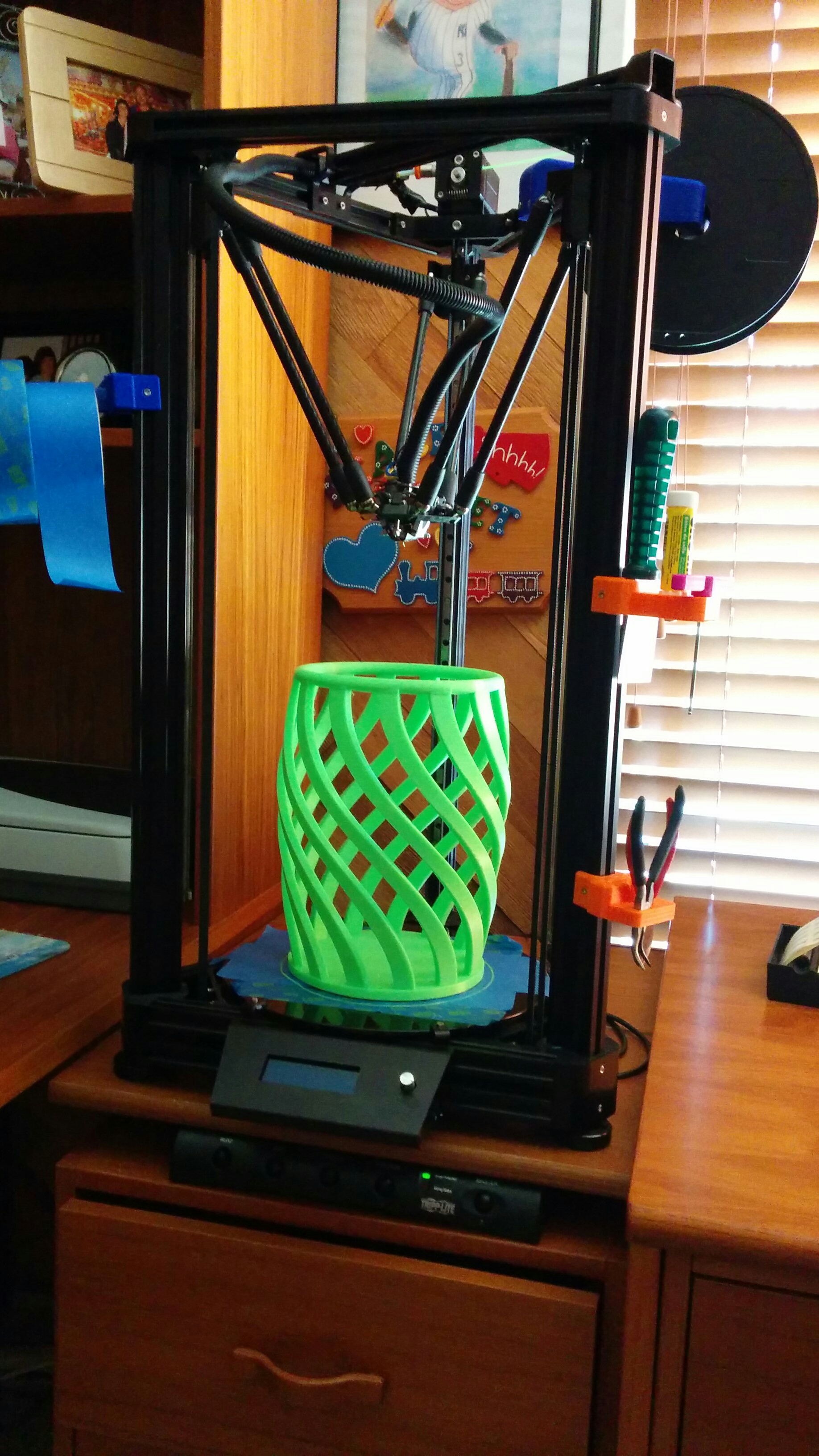

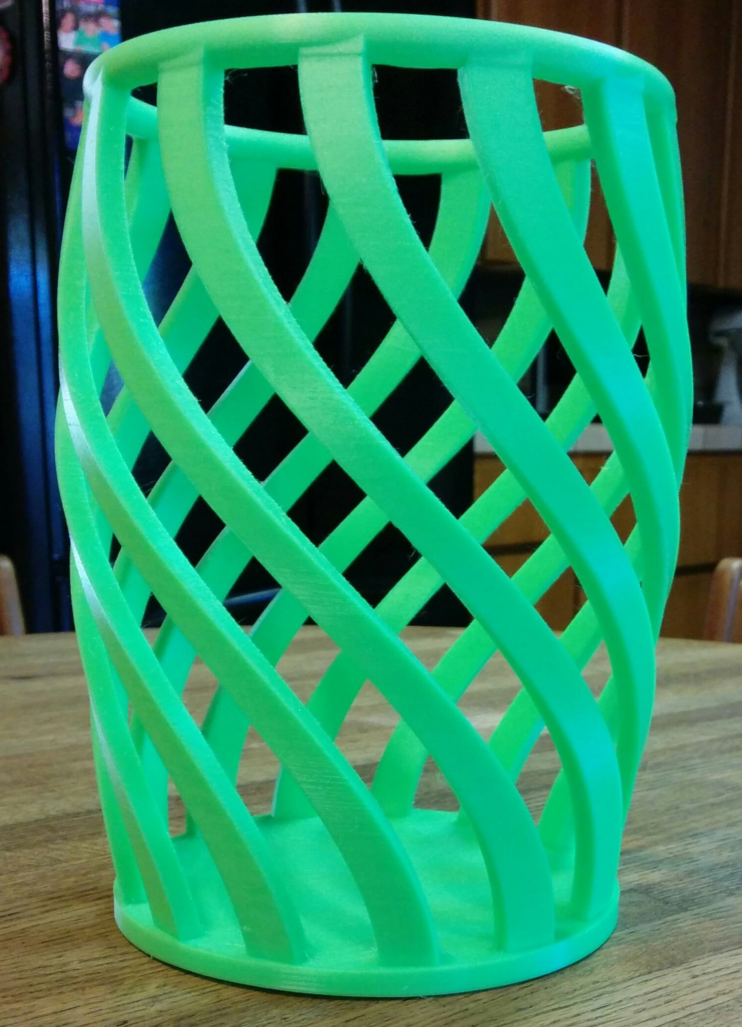

This large vase printed in 34 hours 12 minutes with a layer height of 0.200mm.

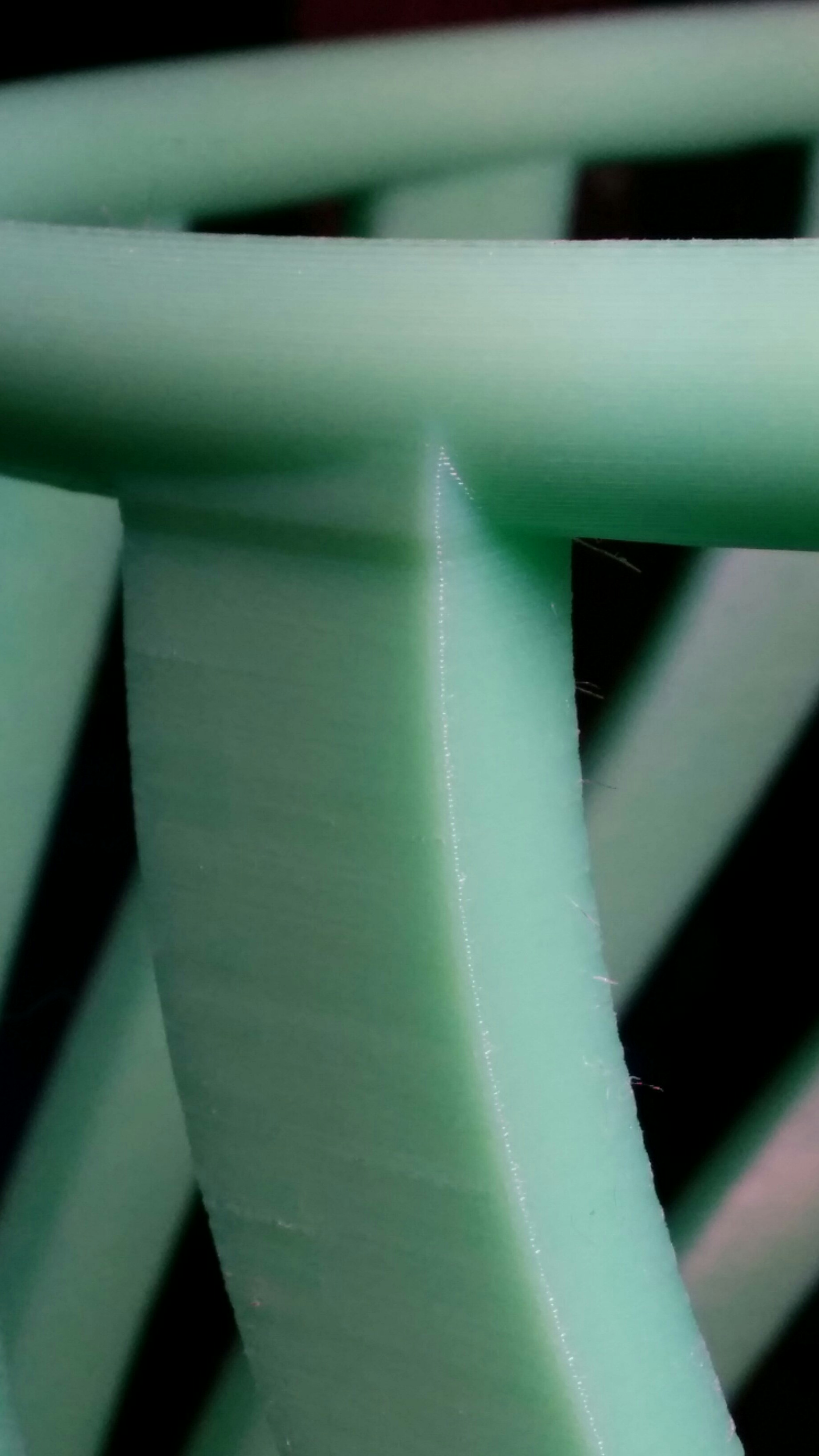

I sliced ​​it with Simplify3D and had no problems with printing other than a fair number of hairs. I used a hair dryer and a little sandpaper to get rid of these .
I have done a number of experiments involving retract length, retract speed, Z-lift, and varying temperature, and it seems that it is just not possible to eliminate hairs with a Bowden-tube style printer.

Nice! That's a huge print! Very impressive results with so many retractions and jumps between the different spirals
