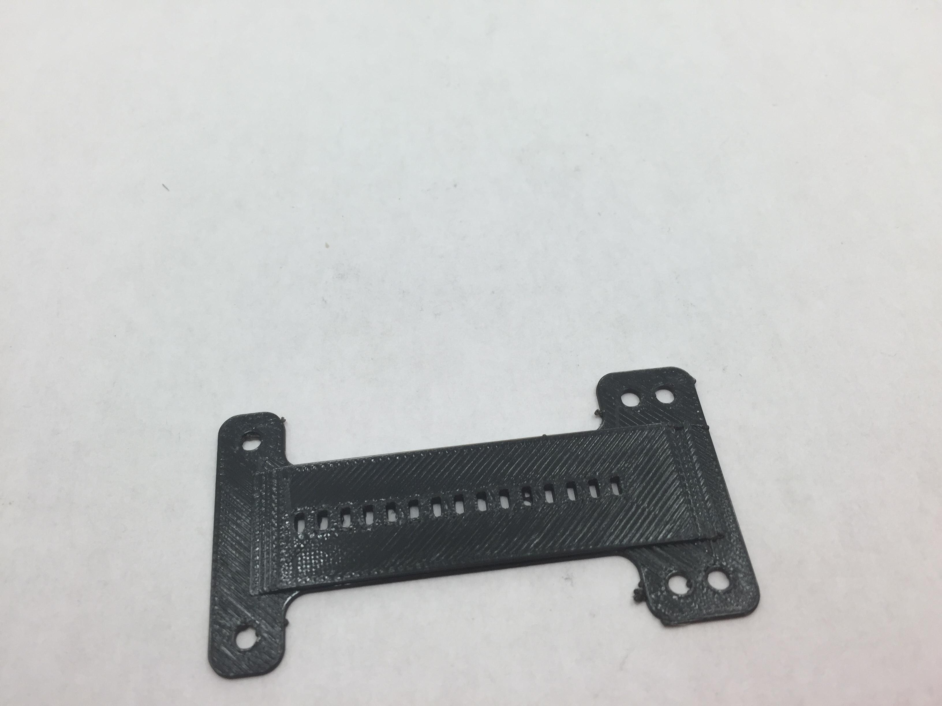

Using Simplify3d for the slicer on both of these... The attached images are of successful prints off Bob, Robert can print the taller hollow square (gopro camera mount) just fine, but he has trouble with the mounts base (the flat piece with the small holes up the middle.)
Robert does fine on prints with long lines and minimal direction changes. He has some problems with smaller circles, and utterly fails to print small squares side by side like you see in the base. This is particularly visible on the first layer in that the longer lines stick to the print bed just fine but the smaller moves tend to not adhere reliably.
