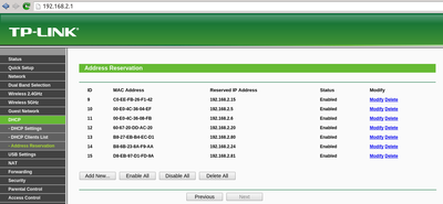

2 - go into the wireless router's DHCP settings and configure the flashair so it always gets the same ip address. This way, every time you turn you printer on or off or move the SD card, you know that it will be at the same address.

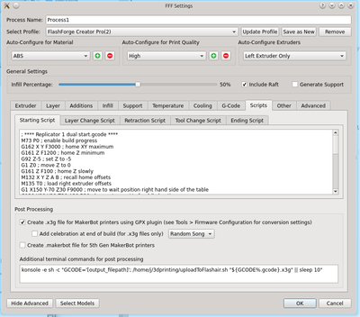

5 - Add our helper script to Simplify3D's additional commands. Go to the 'Edit Process settings'->'Show Advanced'->'Scripts' screen. At the bottom, find the box for additional terminal commands. Here, you can call your upload wrapper script. There are a couple placeholders you can use that get swapped out for the output path and output filename.
in my case, I used
Code: Select all
konsole -e sh -c "GCODE='[output_filepath]'; /home/j/3dprinting/uploadToFlashair.sh "${GCODE%.gcode}.x3g" || sleep 10"
This opens up my konsole, runs my upload wrapper script, and passes it the full path to the gcode file, but replaces the ".gcode" extension with ".x3g". And if that fails for some reason, it waits 10 seconds to allow me to see the error. You'll need to change this command to something appropriate for your computer and printer.
6 - test it. If you did everything right, then load up a model, click "prepare to print" and when you "save toolpaths to disk", it will do like it normally did, but it should also call our wrapper script, which waits for the x3g file to be written, and passes that file along with our flashair's ip address to the upload.py script, which uploads the file and then verifies it. If everything works, then you have to add the script command to any of the profiles you use for this printer.
This is a gist with both the upload python code and my wrapper script. https://gist.github.com/giantpune/4642bcac24604ac9edf5
