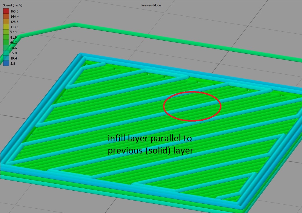

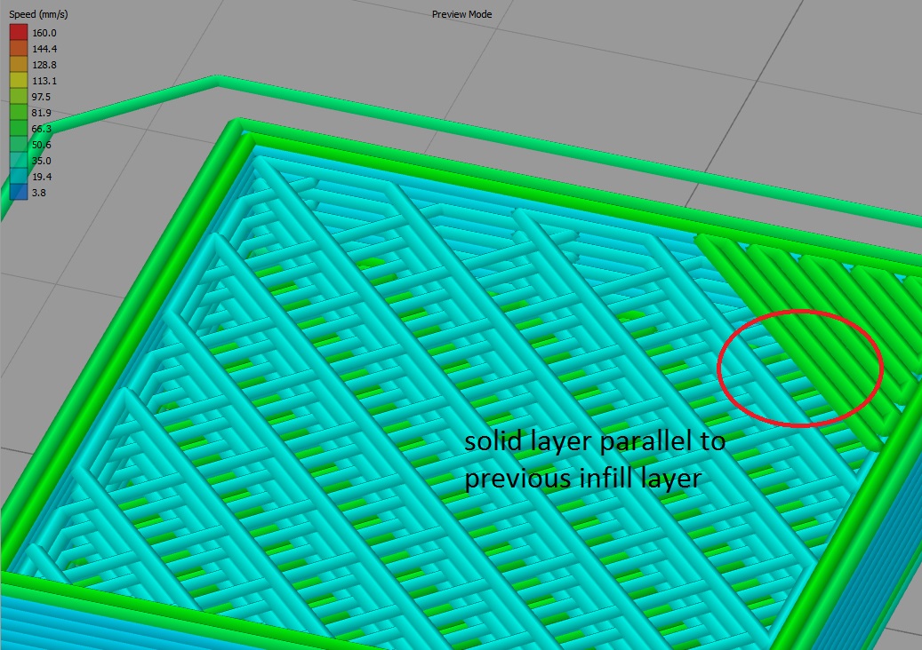

first top solid layer aligned with previous infill layer
Several times and for different models, S3D has printed the first top solid layer in parallel with the previous infill layer instead of printing it perpendicular to the previous infill layer. Obviously, this causes a visible rippling effect as the extruded plastic of the solid layer droops down through the gaps to the penultimate infill layer -- so much ripple that it is visible even through a second solid layer.
I can "fix" it by tweaking the layer height until I get the infill/solid interface back in sync, but I would hope the slicer would get this layer orientation right as a normal part of the slicing process.
Is there something I've overlooked in the settings that controls this behavior? I don't believe this was happening with pre-3.0 versions of S3D, but I'm not positive.
Robert
[edited to add factory file and preview photos]
Preview of first solid top layer on previous infill layer
Preview of first infill layer on previous solid layer
Cube test for layer alignment.factory

I think this might be related to the issue I am having in my slicing error post. Again able to clear it up by changing the layer height. Perhaps there is some kind of round off error in the slicing engine.
