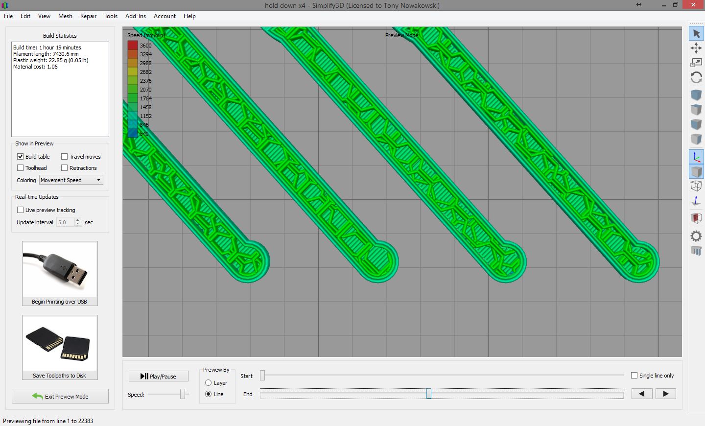

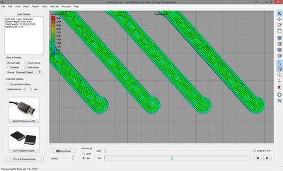

Full honeycomb alignment off at first
Thought this was an interesting find...
Initial
Initial
It's misaligned until you change the infill type to something else, then back to full honeycomb.
After Change
After Change
Re: Full honeycomb alignment off at first
check to make sure you only have one infill angle entered. it should be zero and nothing else.
Interesting! Good call.
