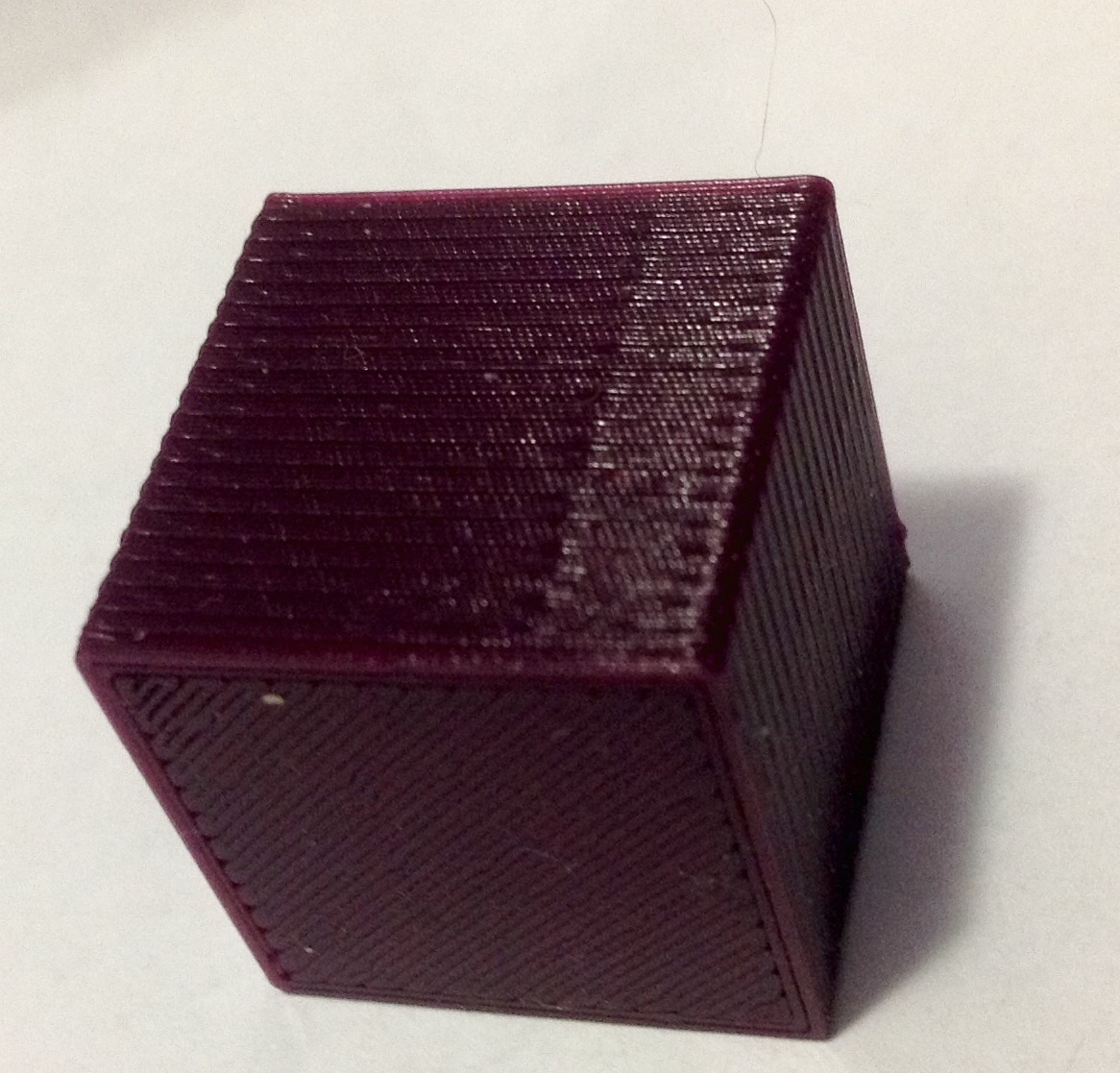

I tried to print a cube but as you can see the edges are not sharp. I'm printing with Kossel Mini & Simplify3D I left the default values ​​for the configuration Kossel Mini. Medium resolution Pla 1.75 Nozzle 0.4 Extruder Wade Bowden. You can do something in the settings of Simplicy3D to obtain sharper edges? Thank you

Get a smaller nozzle ;)
The edges are going to have the same radius as your nozzle, so there's not much you can do to avoid that.
