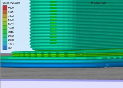

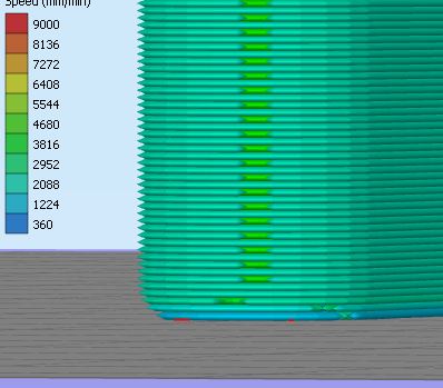

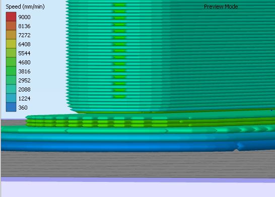

Re: First layer settings
Just downloaded your file and viewed it.....and the behaviour for the first layer is as I would expect.
With raft....first layer of raft printed slowly:
Without raft....first layer of shape printed slowly:
And from the GCode file for second test:
First line speed: Perimeter 1200, fill 2400
Second line speed: Perimeter 1773, infill 2238 and 3358 depending on what its printing
