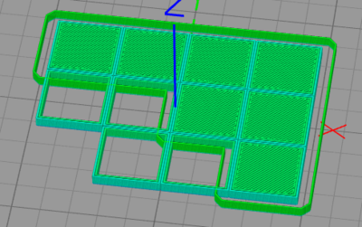

So i try to print this dual extrusion style and I get this: Ooh, that ain't right. Some square missing, others only the outline, no infill, and the ooze wall is totally confused.
I try to fix the model, and it looks like a lot of the corners have been merged, which makes them technically non-manifold. So i create a new one by duplicating the sqaures and not merging the corners and I get: Wait, that's not what I got last time. last time I got them all but the one in the middle. I mean this was closer, but that was closer still. Ah well.
I tried it with a 0.000001 gap between them. It turned out... better? Listen, this is straight messed up. I should not have to go back to RepG to get my dual extrusion on.
