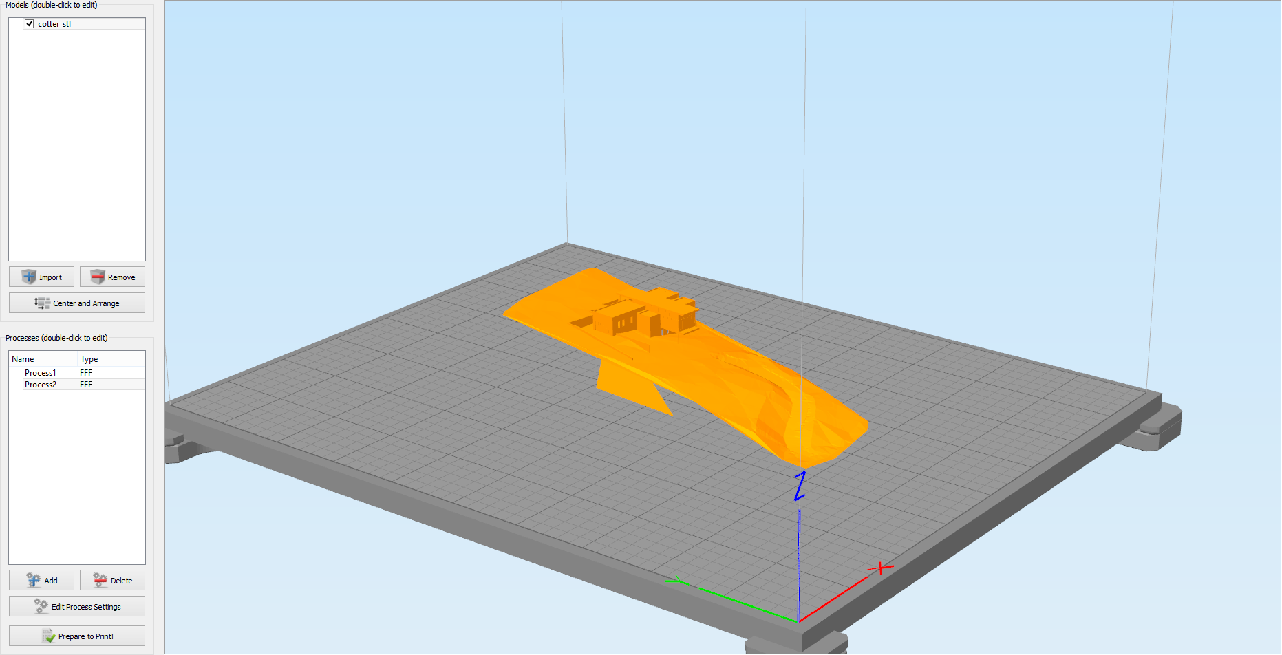

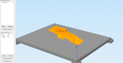

Has anyone had any success in going from Revit to Simplify 3d?

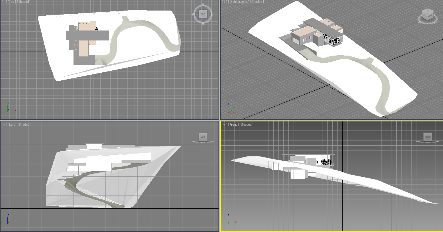

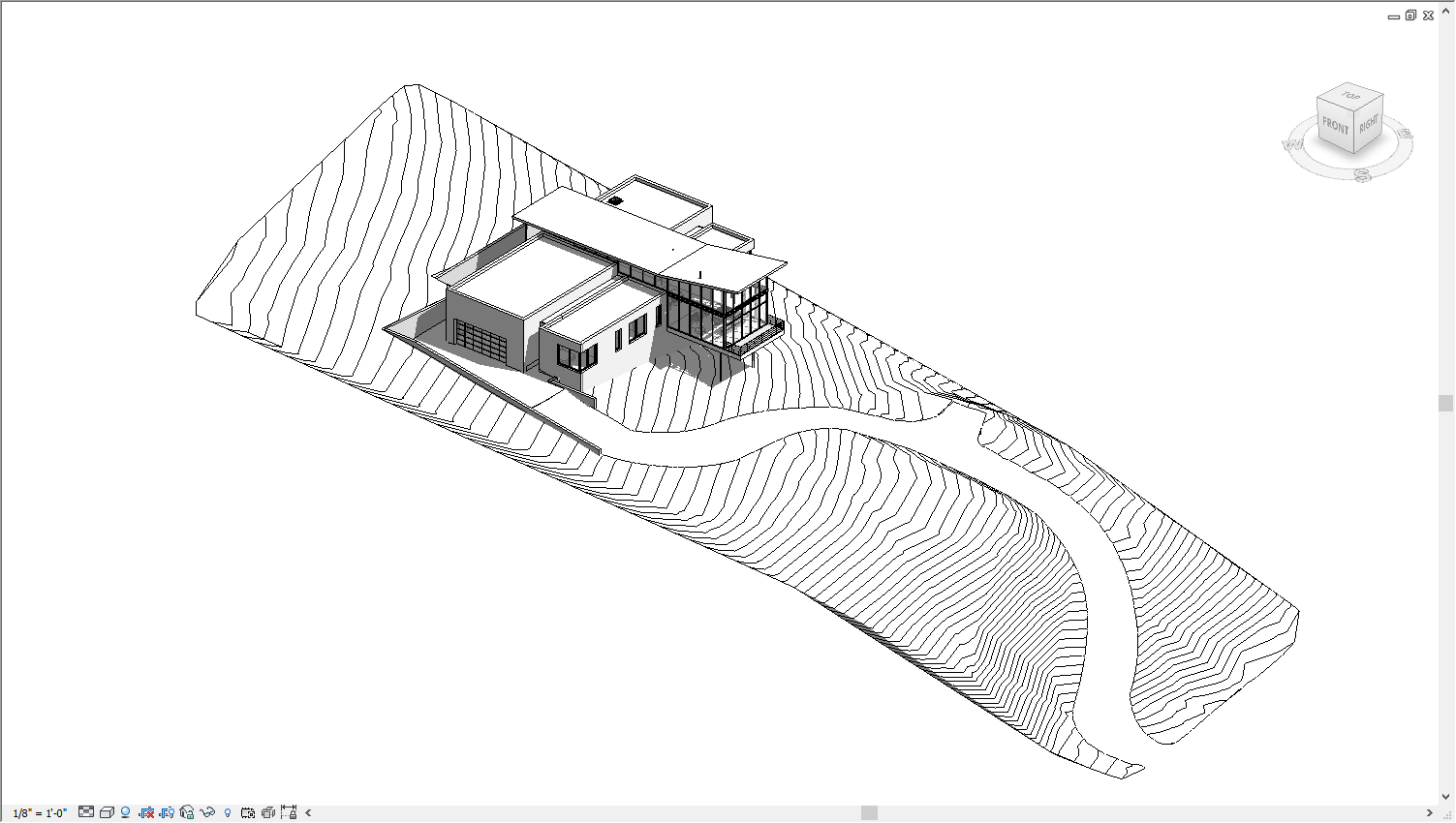

I am having trouble in going from one to the other. Revit has an add-in for STL export, but is not available for Revit LT. Therefore I am bringing it into 3ds, then exporting to STL.
I would like to print the landform with the building, and the landform is coming in very sparsed..
See attached images.
Thanks!

Looks like the resolution of your STL file is very low. I'm not familiar with that exact export tool, but usually you can set a resolution/tolerance to determine how fine the triangles should be that make up the STL

First off - your terrain. Revit will expert a single triangle-mesh for your terrain - this item is NOT a solid. You can however force Revit to create a basic 'box' from the terrain though - use the Section Box setting from the View Properties, and slice your terrain so you can see solid sides to it in the 3D view. When you export this you will get vertical 'sides' to your terrain. You will need to add a base poly however.
Which brings me to - leaky polygons. Revit will likely produce a lot of these, especially in your terrain, and these will cause any slicer to simply skip that object, or do something really strange.
You will need to use either the STL-Check modifier in 3DS Max or the similar function (it might be an extension) in Sketchup to identify these objects with 'holes'. You will probably have to fix these by hand :-P
