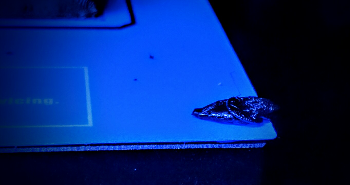

Prior to every print, my printer does what I can only describe as a booger prime. It heads to the lower right corner, squirts a blob of plastic then heads off on it's merry way.
This is all well and good, but I have a glass plate that I want to mount and it will knock right into the retainer if the booger has to be placed right there. I guess first, is there a proper name for said booger, and 2. Is this placed by Simplify3D, or firmware, and lastly where do I go to change the location of the blob?

Edit Profile Settings-->Scripts tab-->Starting Script. Look for a command that starts with G1 and has E values in it. G1 means move, and E stands for extruder.
For Instance,
G1 E25 F225 ;
stands for extrude 25 mm of filament at 225 mm/minute. I'd recommend backing up your profile as is, (File-->Export FFF Profile) then make changes and run tests.
