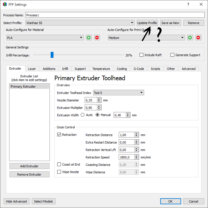

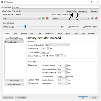

PS I cannot find the import option in the FFF settings screen see attached screenshot. (Running latest version of S3D)
Re: Wanhao 5S
The only difference between the 5S Mini and the larger 5S is the Z-height. So just change the Z-axis build volume size in the G-Code tab.
You can import profiles by going to File > Import FFF Profile...
