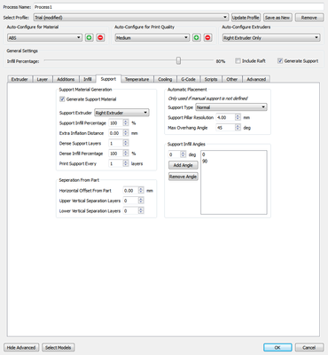

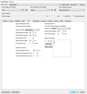

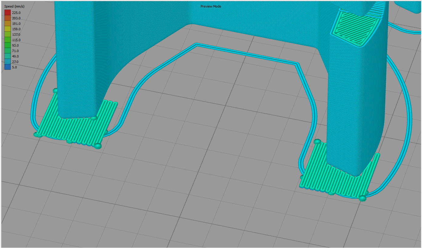

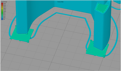

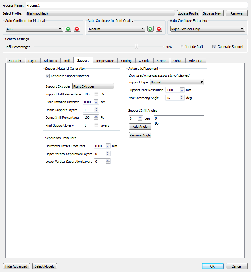

Well you can kind of cheat and do this using the support function. It looks like it might work but not sure as haven't tried it.
Here are some settings you could try.
Mouse Ears
Mouse Ears
Support Settings
Support Settings
Support Placement 10mm
