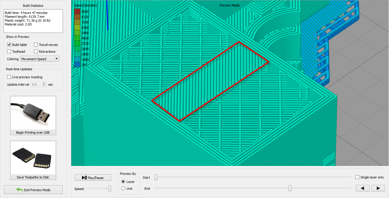

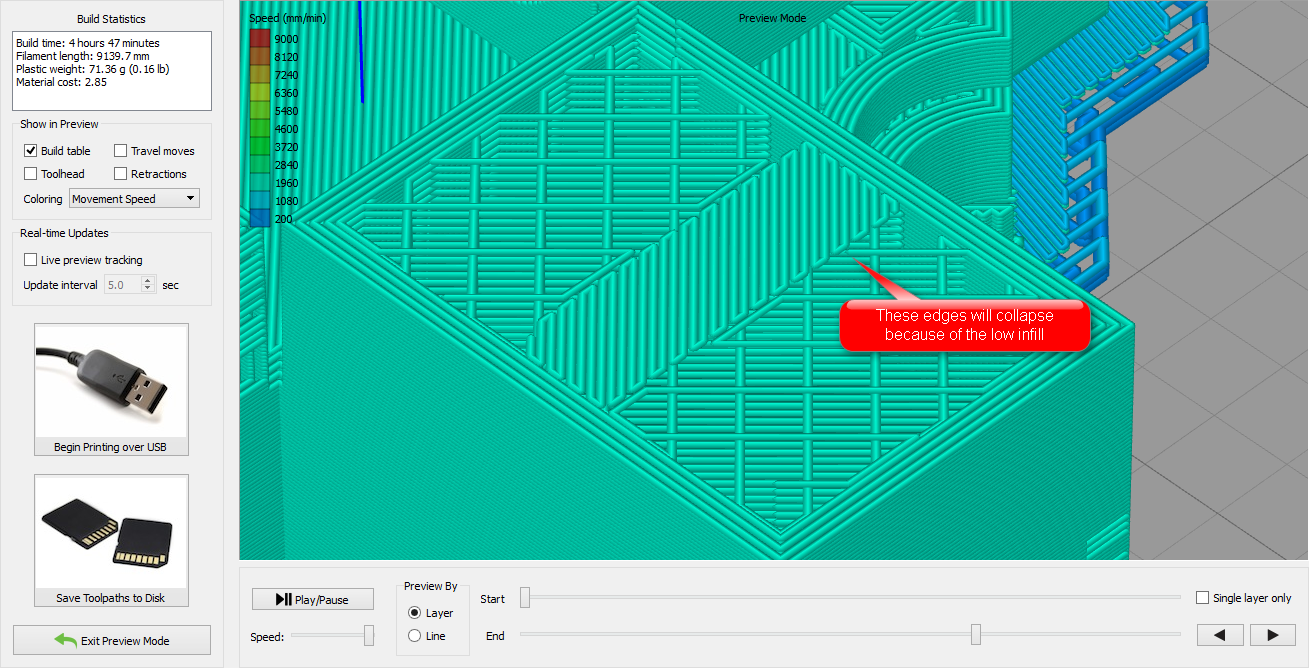

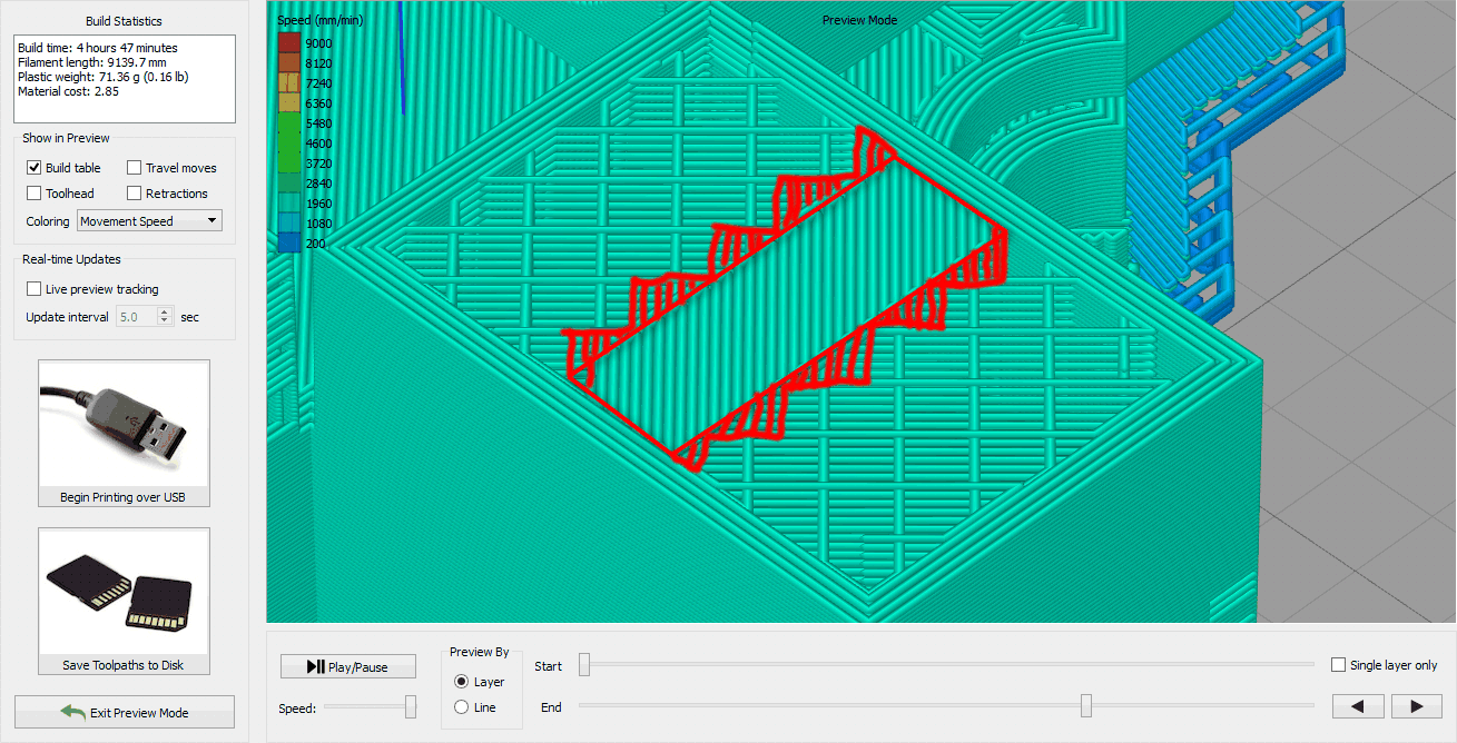

When printing with low infill, partial solid layers, or what I call platforms, can collapse at the edges because the low infill doesn't provide enough support. A simple solution is to add an option to outline before printing the platform. This would be similar to how a bridge works, by providing a perimeter for the edges to adhere to. The images below should make it clear.

But just framing it will not work with a rounded solid platform....
Maybe extending the solid platform to next infill-wall is the solution.
