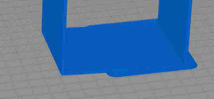

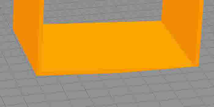

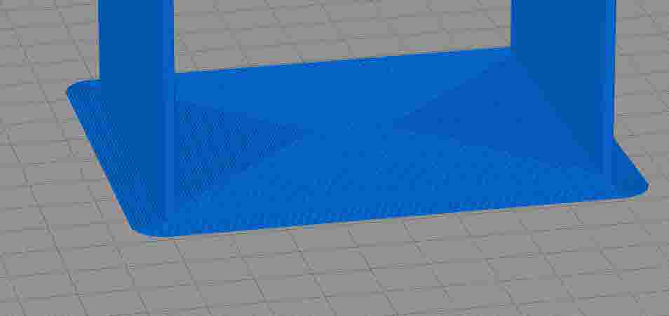

Posts: 861
Re: Model won't drop to table
The best to prove that, is the Print-PreView .
Therefore check BRIM with a very small OffSetFromPart, e.g. 0.05 mm
Is all correct, BRIM follows the outside-conture of the object very exactly. Is there a gap between object and grid (table) BRIM will subvert the object there.
I have made an example, have a look to attachment.
Stand schief.jpg (5.59 KiB) Viewed 1685 times
Brim schief.jpg (6.09 KiB) Viewed 1685 times
