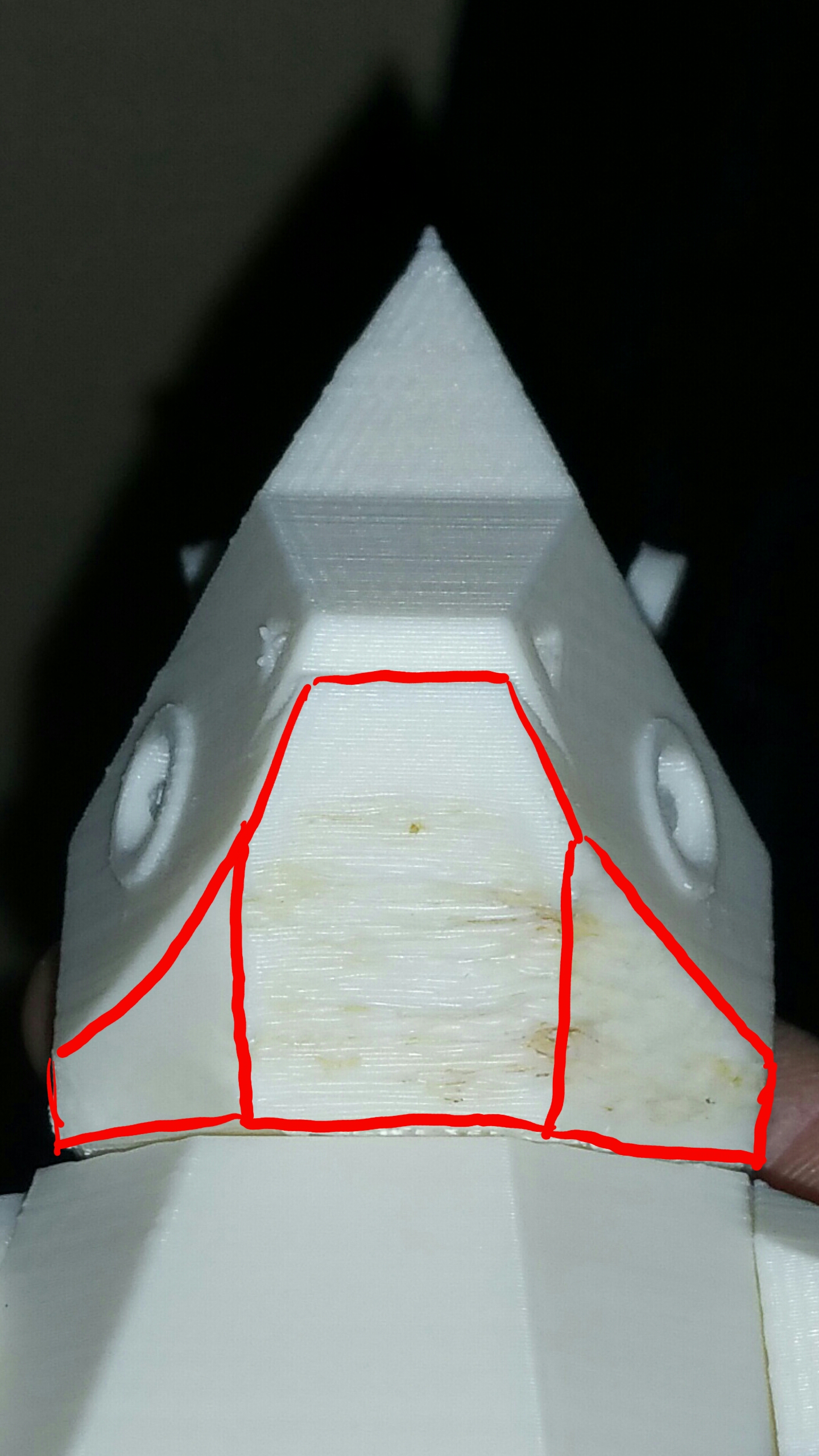

So what is happening is that my models that need supports are getting ruined when it moves from a support to the actual model with an upwards incline (pictures attached). It's almost as if the edge is curling up and melting/burning on the extruder. I have not tried this using PLA yet. I'm not sure if i just got a bad batch of ABS that came with the printer or what's wrong with it. The printer is a FlashForge Creator Pro.

Yup, I've seen something similar many times. It's always a cooling issue. If the plastic is too hot, it will curl. This is particularly bad on corners and overhangs.
Try lowering the temp or adding a better cooling fan for that section. There's more info on your exact issue here: https://www.simplify3d.com/support/prin ... gh-corners

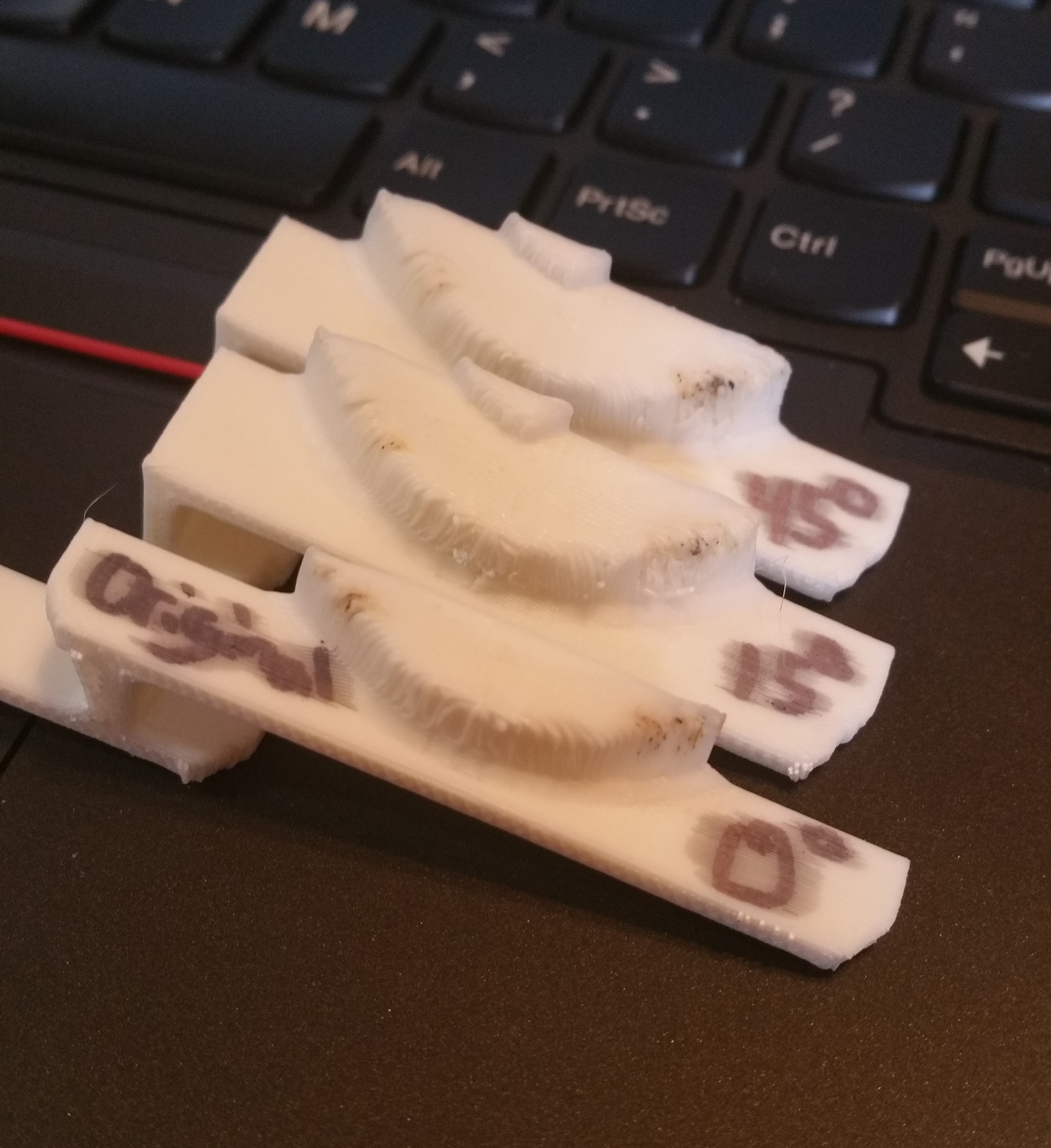

I have increased the fan speed throughout the print but I'm not having much luck with that. I will be dropping the temperature from 230 to 225 Celsius for my next test and see if that has better results. Fan speeds tested were 15% and 45% ( see picture below).
