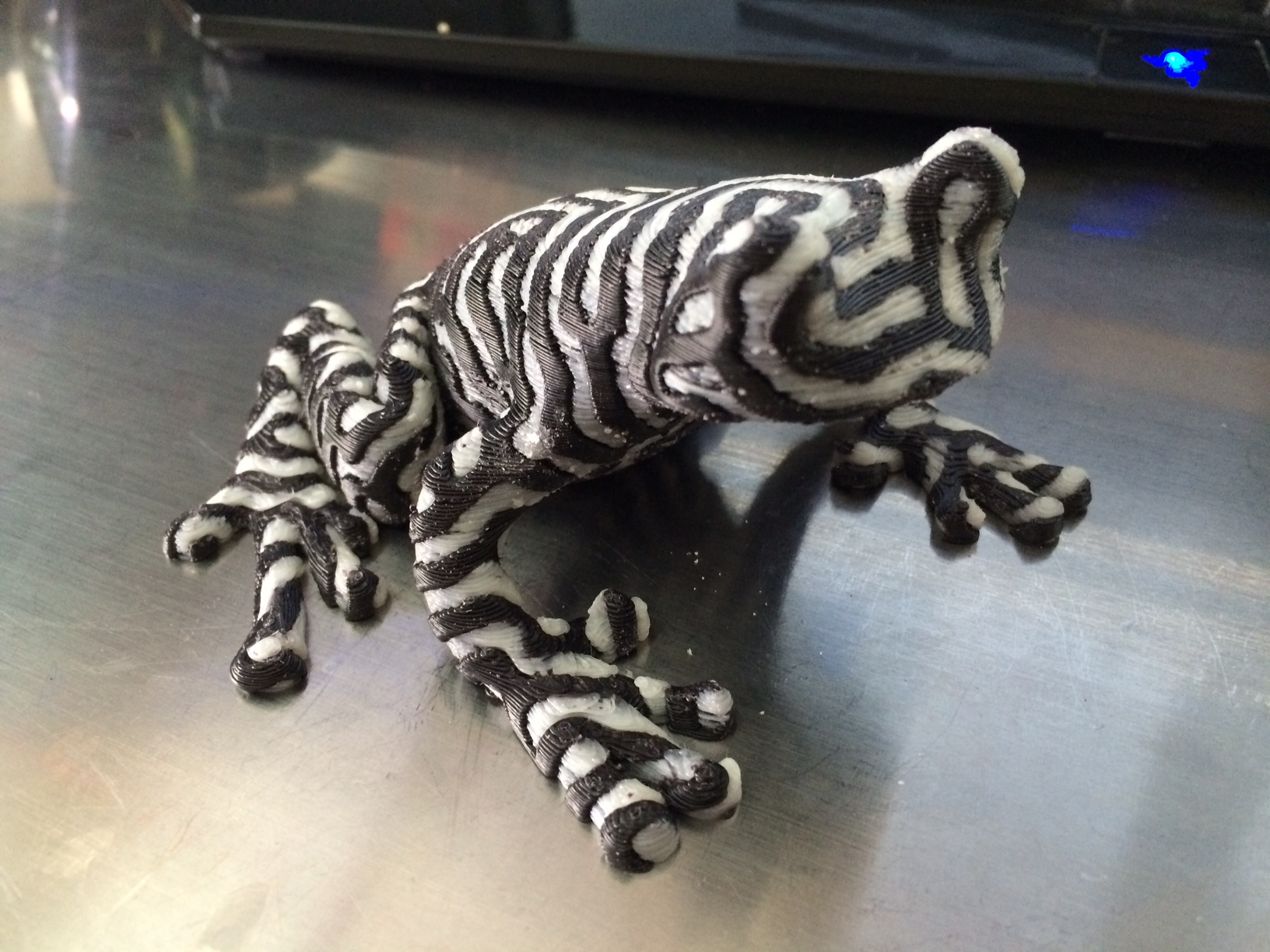

I am trying to use the ooze shield on a dual extrusion print, but I am running into issues with retraction. I have my retraction settings working well for each extruder and I dont see any ooze when I print parts using single extrusion mode, but when I print dual extrusion parts, I get a lot of ooze between the prime pillar and ooze shield movements. I dont think that the slicer is retracting at all when printing either of these objects. the part looks great, but I get ooze between the ooze shield and the part, which kind of defeats the purpose.

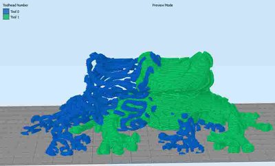

I don't know why, but there is a offset for T1 set to -26,80. The 2 parts are coming together when the offset for T0 and T1 are zero and they are centered.
Additional the model has non-magnifold edges

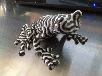

The offset is just in the display due to the 2 heads. The part prints correctly, with the exception of the oozing problem.
Posts: 861
Re: Ooze shield retraction

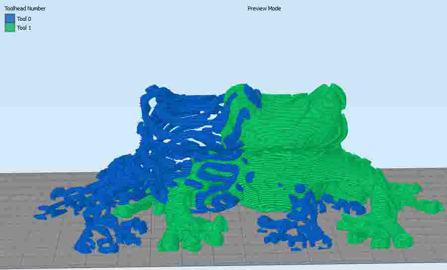

... that is what I don't understand. The model is shown correctly in the setting-window, but in the print-preview it is deformed. Very strange!
H.
downeym
Joined: Mon Dec 28, 2015 7:10 pm
its not deformed,. it is only reflecting the offset between the two nozzles of 26.8mm
