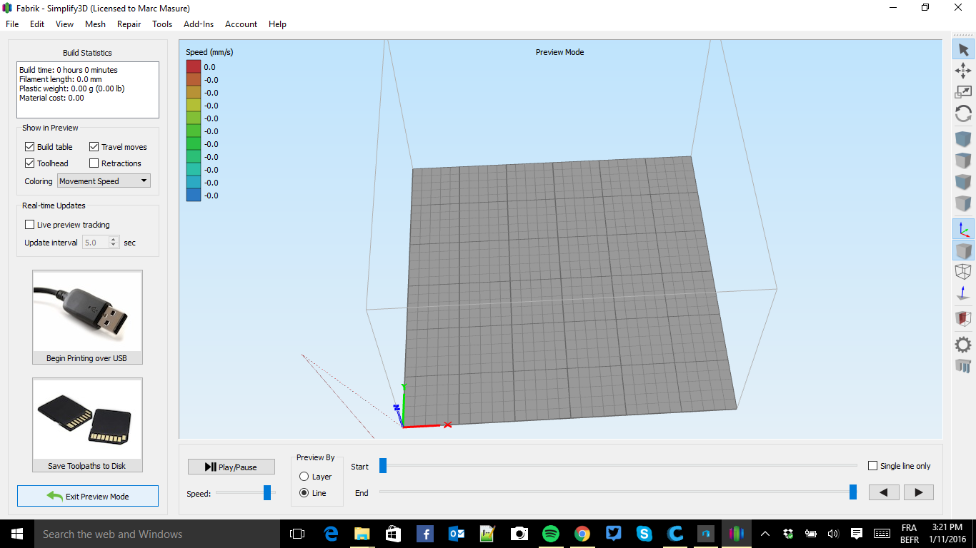

Also What is see in
Prepare To print...
Prepare To print...
Thanks.

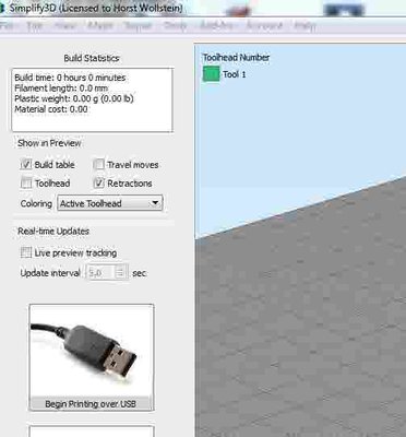

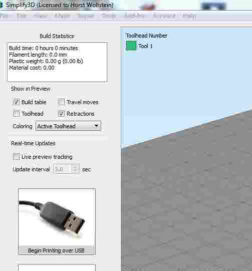

I have the same issue - no slicing possible.
H.
It seems to be an issue inside the stl-file. While S3D doesn't find an issue, netfabb is able to repair what ever.
side_brace_fixed.stl
(314.63 KiB) Downloaded 215 times
