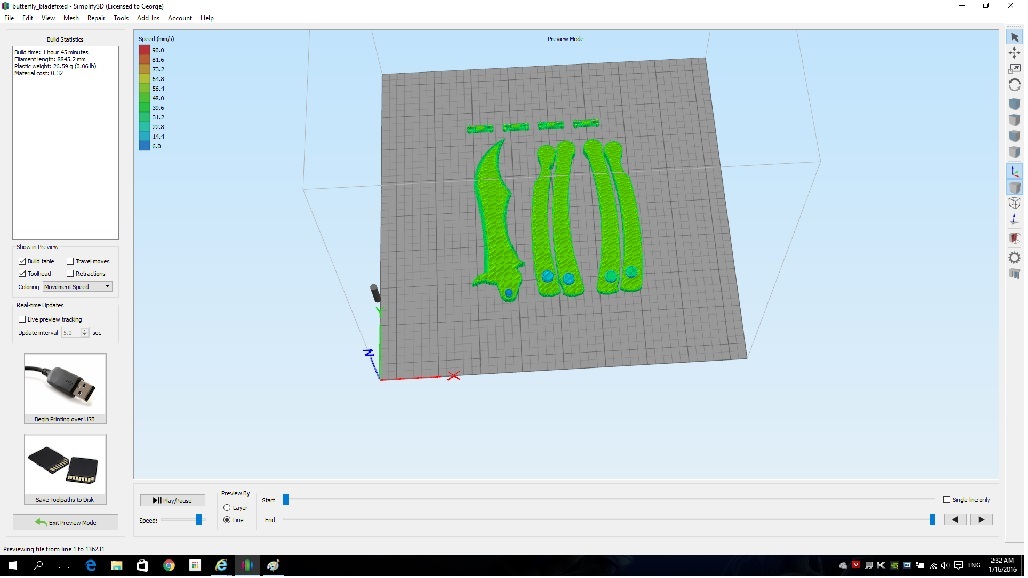

I have a problem with a butterfly knife I want to print.
In S3D the holes are not printed as you can see in the print preview screenshot. Factory file is attached.
In repetier host, the print is perfect,
What am I doing wrong in S3D? I have so much printed without problems, but these holes are totally disapperead.

Edit your process, go to the advanced tab and deselect 'Merge all outlines into a single solid model'.

Wow, that was a quick answer!
You're absolute right, have forgotten to uncheck this.
Thanks a lot!
