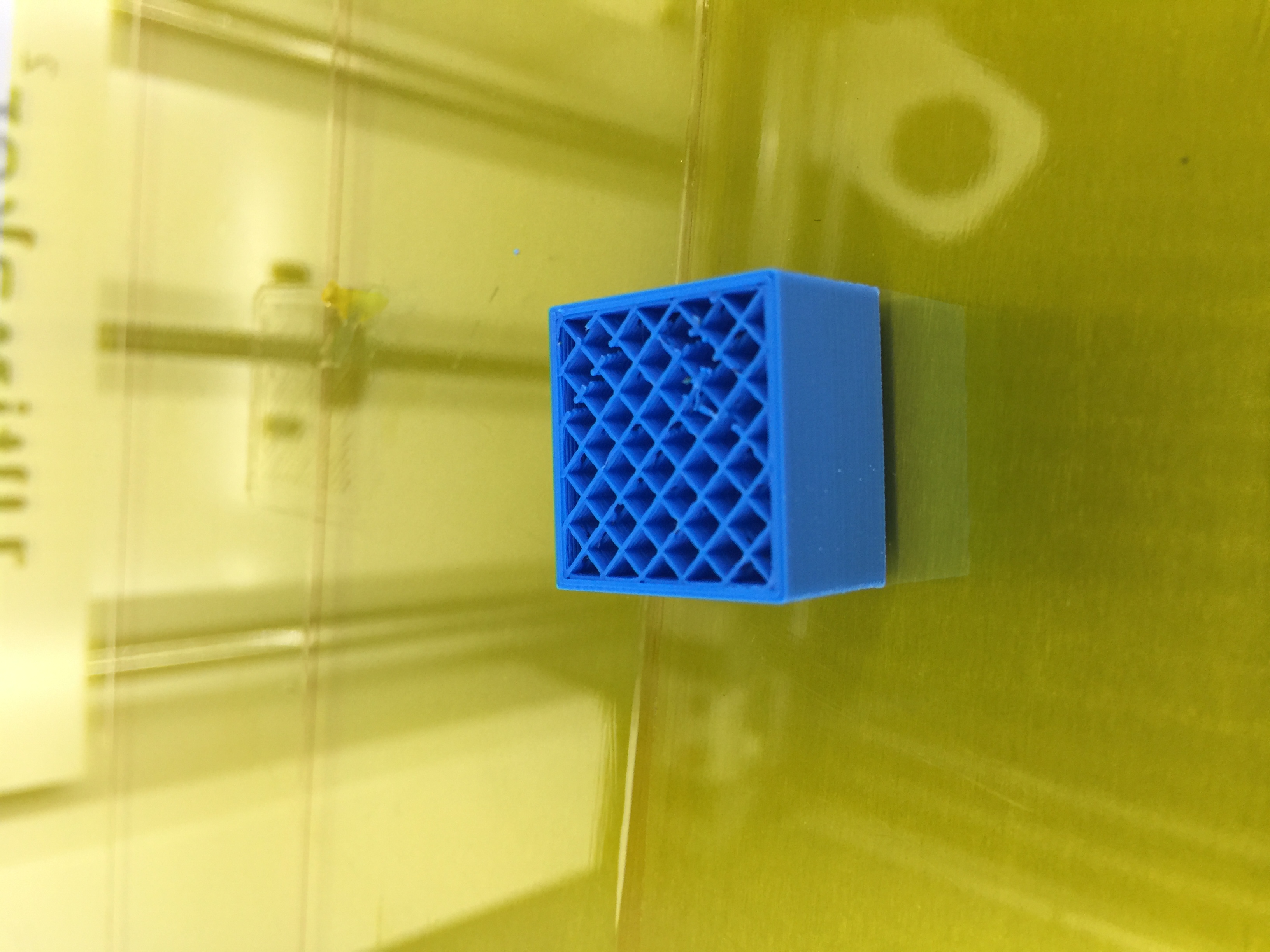

I am able to print flawlessly in PLA at the Simplify3D setting of 41.5mm/s however I am not getting any decent prints with ABS at similar speed.
The picture below shows ABS being printed at 18mm/s and as you can see the interior support is not bonding. The outside is fine however.
Failed print at 18mm/s

I would try increasing the temperature first. Typically, as you start printing faster, you also need to run the nozzle a bit warmer so that you can extrude the plastic quickly. Of course, lowering the print speed would also help or increase the infill extrusion width %.
