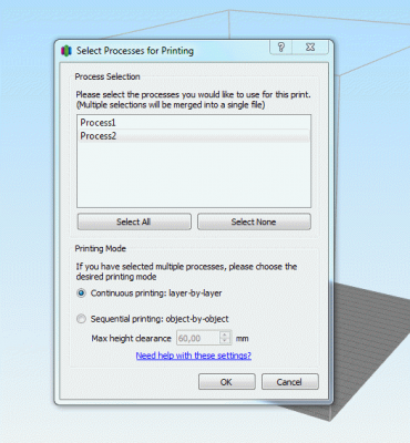

... yes, but you have the occasion to exclude a process from printing in the following window, when you have select the "Prepare to Print"-Button. And this is exactly what you want.
GER
Not really. I don't want to necessarily create one process per object. The times when I've done that were either to work around the phantom supports
bug (supports sometimes generated even when removed in the custom supports tool) or to otherwise use different settings (e.g. different infill density).
