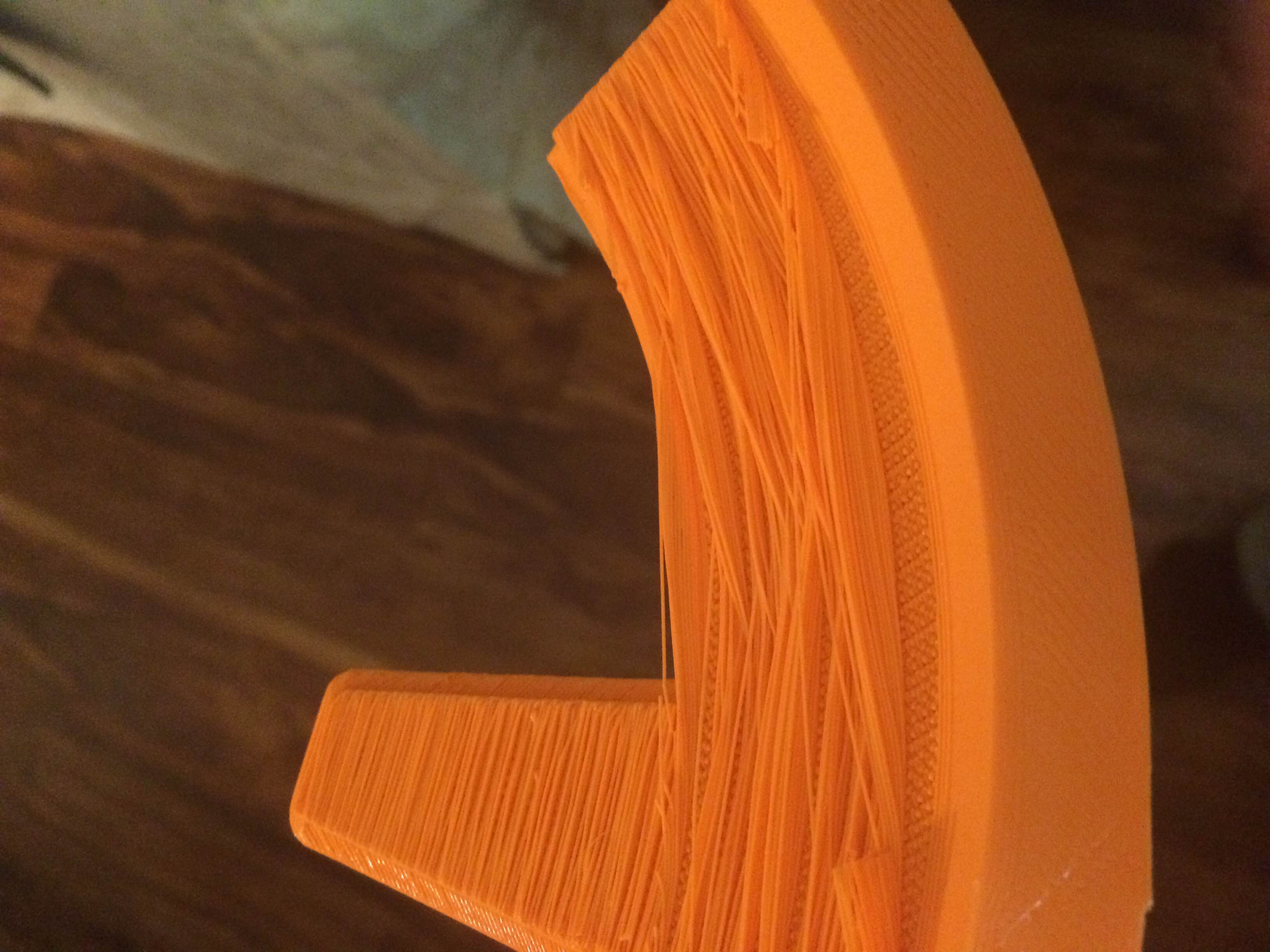

Hello,
I have a problem with the underside of my part that I'm printing. The filament at a certain point in the print tends to not stick and droop which causes the underside of my print to look stringy. I have attached a image. I see there is a bridging option and wanted to know would I have to lower this to get the layers to stick. I'm running my nozzle temp at 230 degrees with 0.2 resolution.
Thanks
Underside of my part where filament is drooping.

Printing at a lower layer height will help with overhang performance and keeping the layers bonded together. Based on your picture, I would NOT recommend using the bridging stuff, as that likely won't help with a part like yours.
You may also have to add some support structures if a lower layer height doesn't solve it.
